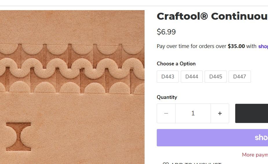

  21. Or a less expensive option at Tandy. https://tandyleather.com/products/craftool-hourglass-border-stamp?_pos=1&_sid=6e3e56c2a&_ss=r

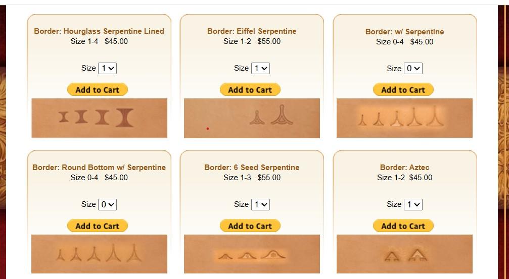

  22. I'm sure there are several companies that have different sizes but here are some styles from Barry King.
