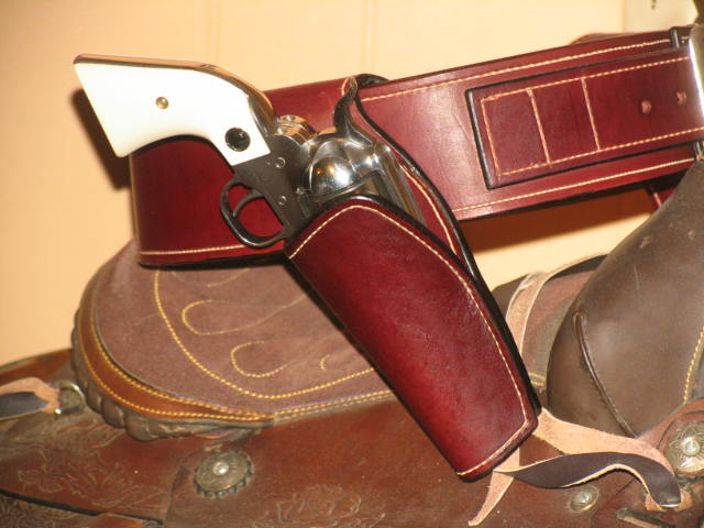

I have a custom rig built by Rod Kibler that has the double buckle. And I like it. The belt is really a just because. I pictured it and I made it. And if I sell it, it will do anything from 40" and up to about 48" or so. Here is an interesting note. I was given a bunch of leather and tools by a friend and cowboy shooter. I mean a bunch. Included was a 3" x 48" strip of leather. The strip was not very stiff but felt really dense. Since I am going to build myself a rig over the winter, I started on the above belt. After reducing the strip to about 40" x 2" I placed it in a batch of proven vinagroon. The strip absorbed very little after a couple of minutes. I dried it in the sun and doaked it again for a couple of minutes. Did not soak all the way through. Worked up nice and took to a needle beautifully. I have a suspicion this leather was a piece of bridal leather or something like that. I have no idea. Anyone? PS: I just realized the center piece of the belt does not have a coat of neatsfoot. -
