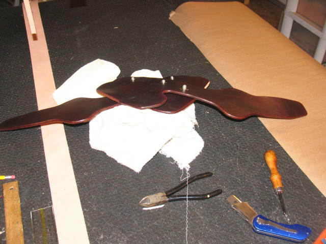

First these are pictures of holsters that I squared the edges, beveled, hand sanded, and burnished with water and my grinder burnisher last night. As you can see, they look like the near holster in the first picture. The far holster has been edge dyed black as will the other one. This morning, I dyed the edges and immediately burnished them. The grinder/burnisher will level any bumps using the wet of the dye and normally shines like crazy. I no longer use Edge Kote nor any of the thick coatings. It needs to be said that the leather is of utmost importance in getting the glass look. Suprisingly, I have found that dry leather (usually cheap stuff) will do this better than the supple/soft stuff. Another discovery is that expensive stuff that has been vinagrooned will do very well. I guess it dries it out, huh? I will now sew the cosmetic parts. Then I apply/rub on a 50/50 beeswax/paraffin mix and burnish again. The burnisher will smooth and melt the mix into the leather. Let it dry and take an old towel and lightly buff. The towel will remove the excess mix, smooth over the irregularities, and, again, shine like crazy. Then I wet the fold lines and glue the main seam. The next day I will take my super smooth/used dowel rod and smooth over any cracks or bumps in the area where the flap goes over the holster. I will take some more pictures later. I use this to hand sand. Tremendous tool. http://www.lowes.com/pd_524021-1069-12192___?productId=50029342&pl=1&Ntt=rubber+hand+sander
