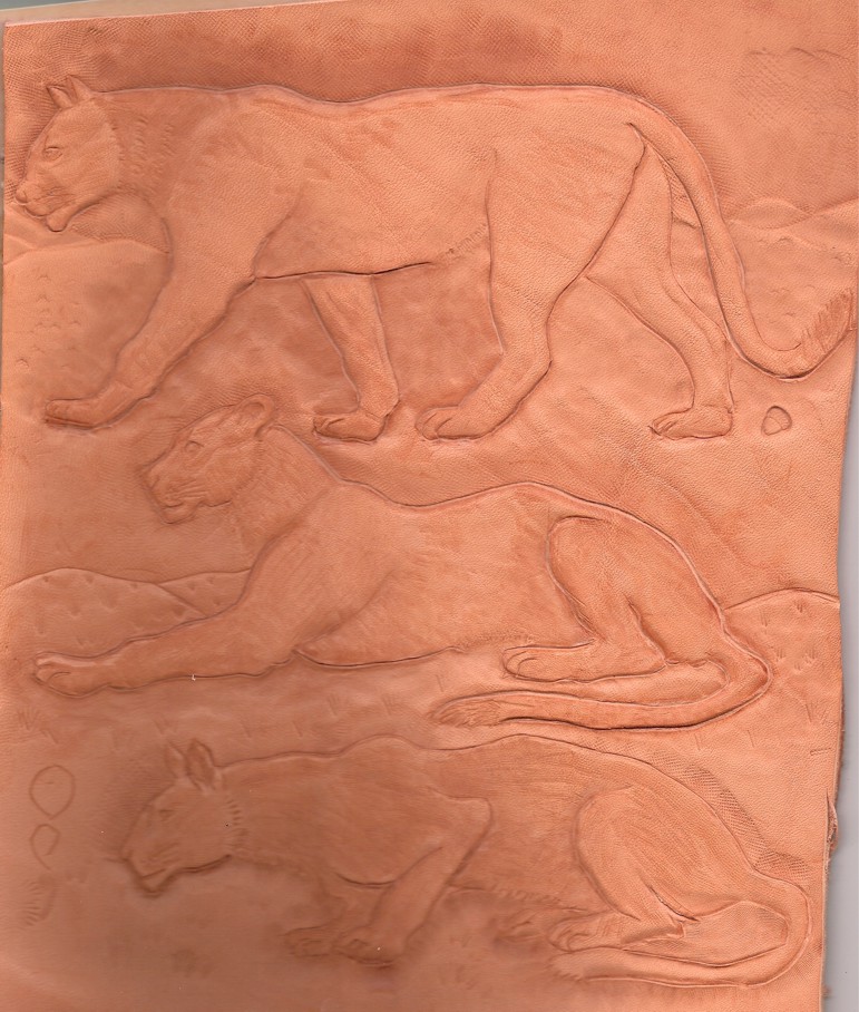

Here are 3 cougars that I've carved. Bottom one was my 5th (2 weeks ago) 6th (middle-last week) and top one is this week. Hopefully each has some improvement. I've gotten some tips in the forum that help me improve. ClayB has been emense help. With each one, I've learned to see more detail and learned to tool with more progression (rather than "BANG"). Even so, I've done a little damage to each one so I'm not quite ready to put one on an actual article YET. I think Clay is going to post one of these cougars done more professionally. For anyone that saw the elephant that I first posted (wish I could delete that post) these cougars are big improvement. What a great place to learn. Regis
