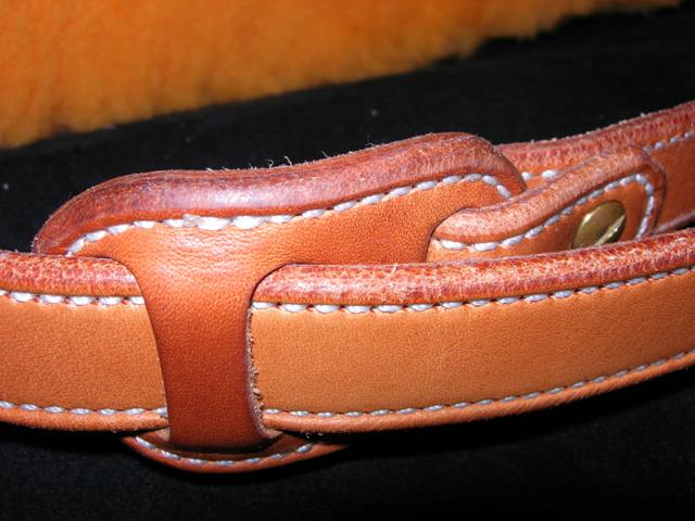

  1. Bruce, It looks like you did a similar handle on the purse you posted today (using 2 rows of stitching). If you Barge, do you still use clips? Or just one way or the other? Thanks Regis
  2. Very nice and like the way you brought the handle through the body. Would you put a holster inside or just let it lay on the bottom! [lol] Regis
