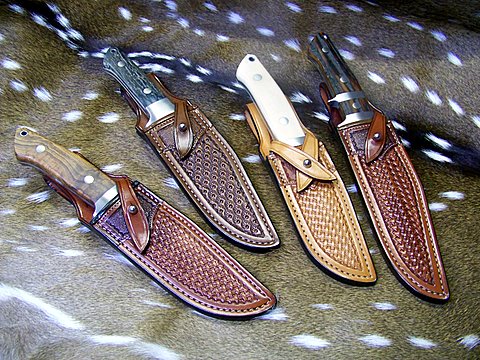

whats the stamp of the second from the right??...i can't tell in the pic but looks interesting... darryl It's a Jerimiah Watt (Horse Shoe Brand) tool. Kind of looks like a pineapple or an upright leaf. I stagger it and then fill in with Craftool S 631 dot. Paul -
I finished up these four sheaths earlier today and tomorrow they will be headed to Cody, WY. I would have shown the knives also, but they still have a little bit of final finish to go and I'm sure the maker would not want to splash them all over the internet until they are truely ready. Wickett and Craig 7/8 oz leather in Russet, Chestnut and Brown. All pieces fully lined. Artisan machinery. thanks Paul
