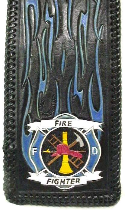

Its been a long time since I posted anything. Been too busy with orders (yippie). Anywho. Here is a wallet I just finished for a client. She wanted a fire fighters emblem, but with a not so traditional twist. So this is what I came up with. I don't think it turned out too badly. I need to work on my lettering a little. The "halo" around the flames and emblem is intentional to offer a little shadow. It is all colored with spirit dyes, cept the white. Let me know what you think.
You are correct. A method I have found that works real well is to do the main color in several coats, thin out the dye and increase the color as you go, this hides the brush marks. Another thing that hides the marks is to color in different directions. The method you describe will work, but just make sure you trim your dauber. I like Peter Main's method of burning it to size, this also eliminates the fuzzies. It is also recommended you use a different brush for each color. And don't forget to use deglazer to open up the pores of the leather and clean the surface.
As Greg mentioned, The only way I know to accomplish what you are asking for is to do it with allot of applied patience and a detail brush. If you want nice looking flames and a contrasting background it has to be done with a brush very carefully. See the attached picture for an idea. Please excuse the crappy pics. The flames are nowhere the quality of flame that Jeff Mosby puts out (not yet anyway!) , but it will get the point across.
