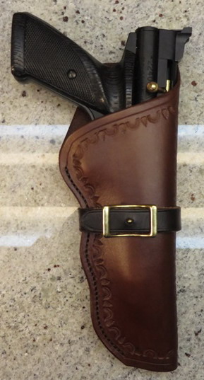

Finally got the nerve to try a toe plug and can say I am please. The leather I was using was a little "wrinkly". I was pleased at the stitch spacing maintenance inside and outside radius but the double back stitch then just looks chunky... but that is where Mr. Stohlman says to do it. I left the edges just burnished as I don't feel edge paint is really period myself.. funny which projects I do and don't edge paint.... Any toe plug tip would be appreciate or general constructive comments on the holster itself. I did learn not to start tooling too late at night as there are certainly some "Persian Flaws" as a result but I think I will see them ore than anyone else. There is after all only one perfect "Maker" and it sure ain't me! This is show with a Crosman Shiloh which replicates the Remington 1861 New Army And now I am hooked an want to build more with plugs and already have another on the go for a Crosman SA6 Colt SAA clone. Anyhow have look the giggle even. Thanks.
