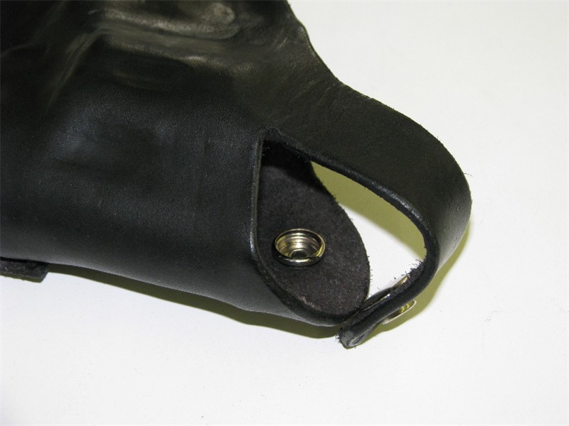

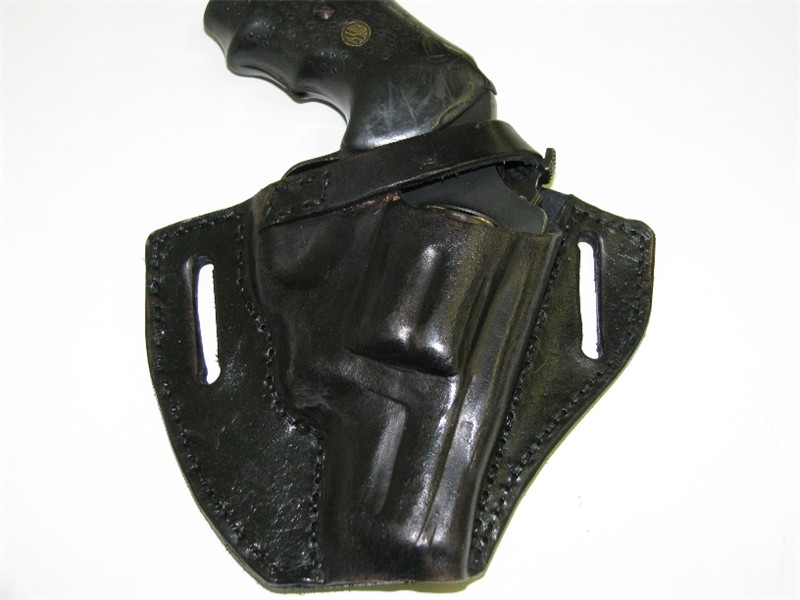

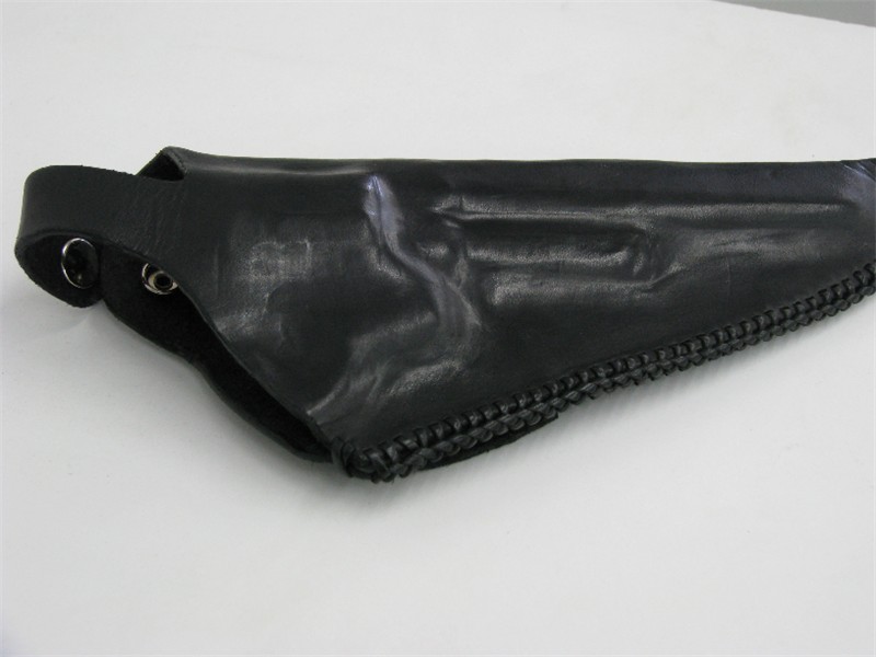

Here's pics of a hoster for a Rossi 6 shot snubbie. Owner came to me because he couldn't find a holster in his gun shop (as in he runs the gun store) for a 6 shot cylinder. More orders pending!!! Holster is spirit dye black, but b/c of rub off, I needed a good finish, so I used the Fiebing's black edge cote (with applicator) on the flats and back, and super sheen on the molded portions.
quote name='TwinOaks' date='May 5 2008, 08:29 PM' post='45587'] Uh, yeah.....probably next weekend. Camera was kaputz, and I had to deliver the holster. I'll ask the guy if I can get a pic of it. I'll also ask his boss for a pic of the snubby holster I made for him Okay, here we are a few weekends later than promised, and a new camera later, but I got the pics. Appologies for the delay. Here are the pics:[
Hey, Shorts, I've got a suggestion, but I don't know if you'll like it. Deglaze, and strip as much as you like, then make up a quick batch of vinegaroon. You're still over in Japan, right? I know getting some spirit dye might be a problem, but you should be able to get your hands on white vinegar and some scrap metal (iron based). I'll post the pics of the holster I did in 'more vinegaroon ...' this A.M. I also did a holster for a snubbie, that I finished with edge cote, of all things. It turned out really well. After all the problems you've had with this batch of leather, I'm beginning to think you got a bad piece. Other options...well, can you get some charcoal and some Sake? There's your two ingredients- carbon and alchohol. You may even have to go with an oil based pigment, but here, I'm not familiar enough with the restrictions on shipping to be sure.
