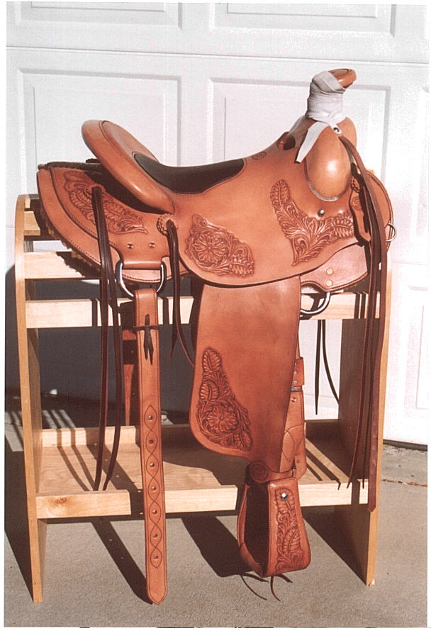

I built my own with barber chairs... I'll post pics for you can see... it works good
That looks so incredible fun, i have a grinn from ear to ear, just thinking about doing that....
