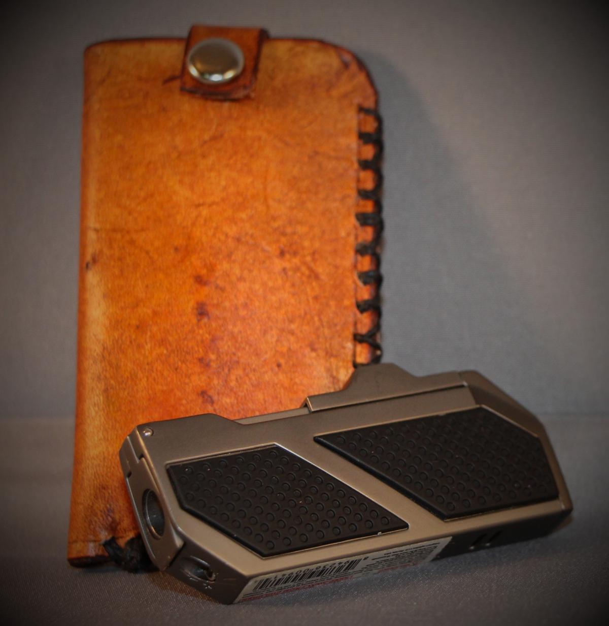

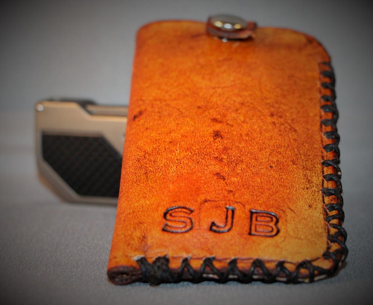

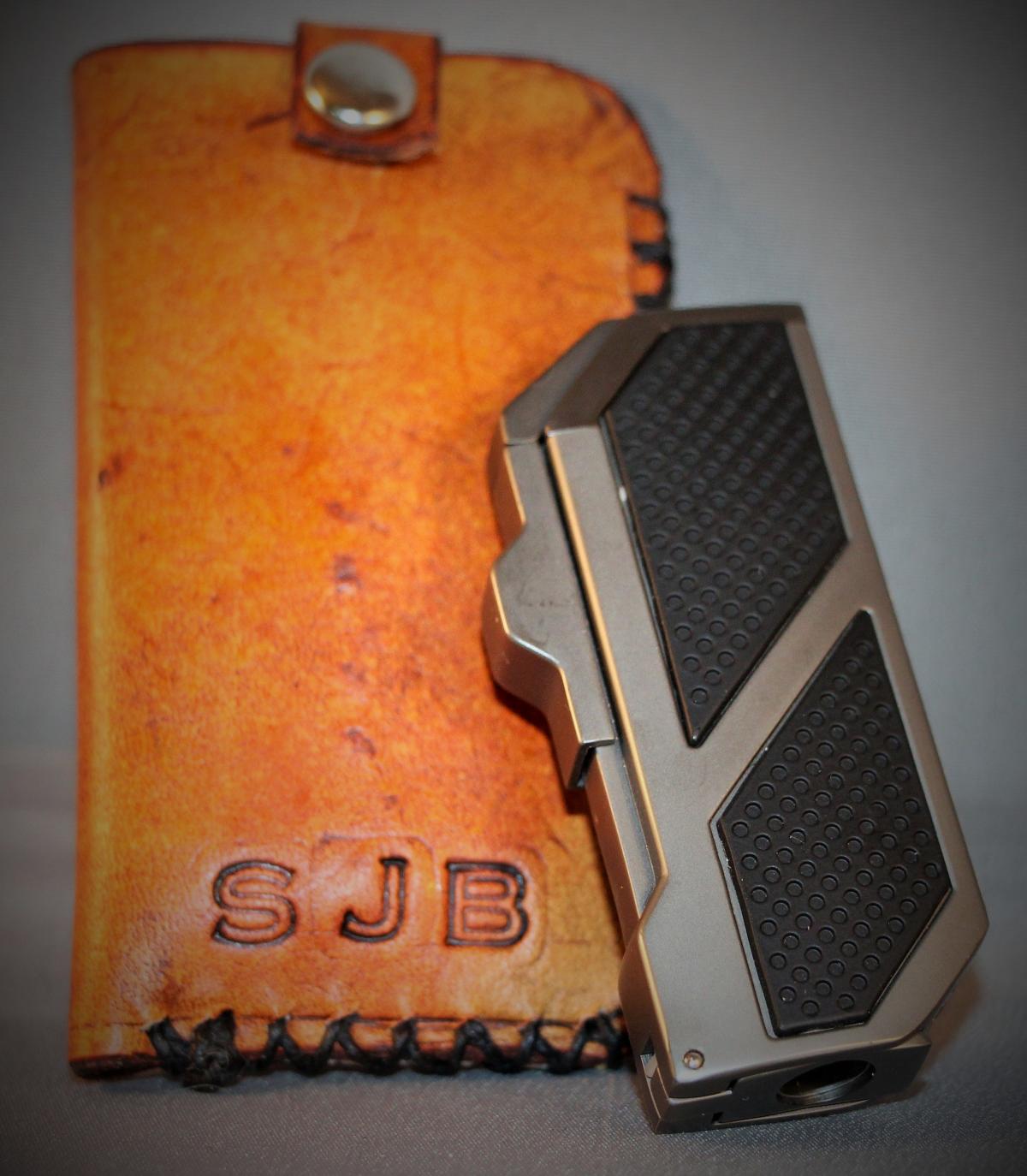

Lighter Pouch
venator replied to venator's topic in Purses, Wallets, Belts and Miscellaneous Pocket Items
Thanks, it was a quick project as a request from some scrap I had. -
