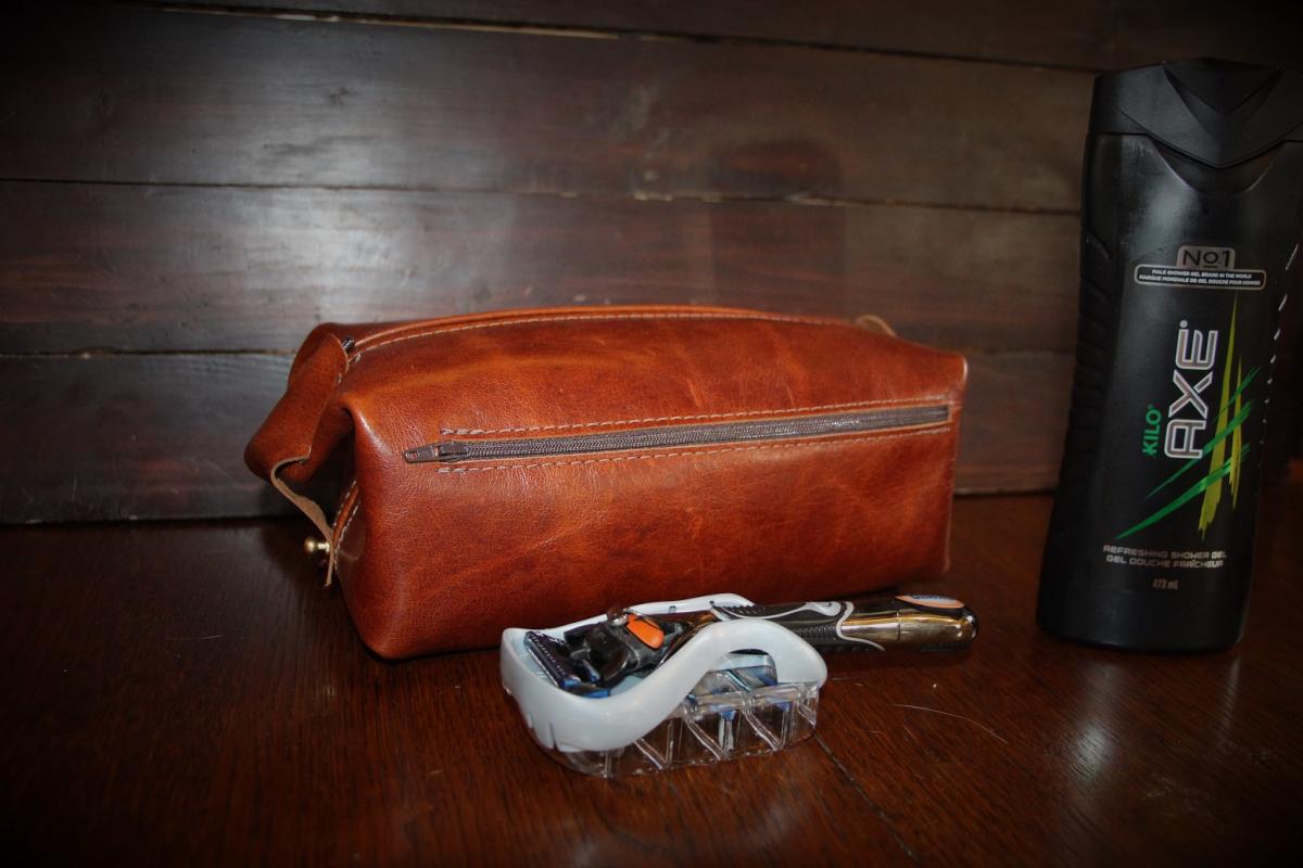

	  Shaving Kitvenator replied to venator's topic in Purses, Wallets, Belts and Miscellaneous Pocket Items Thanks, I'm pretty happy with how it turned out.
