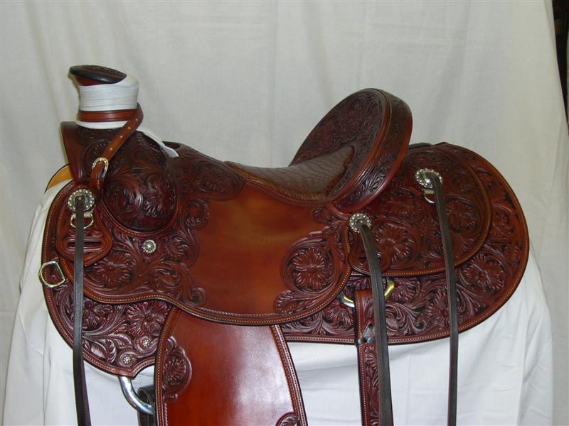

I use a pedestal saddle stand made of pipe and steel rod, and we cover the base and pedestal pipe with the same paper that we use for the backdrop. I do spend the money to have the saddles professionally photographed. I think it is worth it for promotional use and advertising. -
