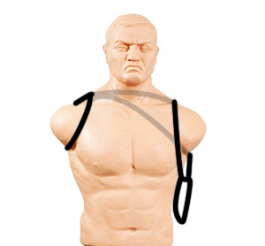

I think you have it. My comment about it being an M3 design is based on the pattern, not how it's worn. I'd be surprised if the M3 wasn'tworn in different ways during it's tenure. Nevertheless, it's clearly atried and true method. I'd personally prefer a larger grip area cut out from it, and a proper fit that's been molded. I could live without the retention strap myself. From the way I read it, it looks a littlesomething like this when worn -

Yeah, looks just like the M3. I think a cut under the grip to allow better draw would help. Here's a photo of someone wearing this style holster:
