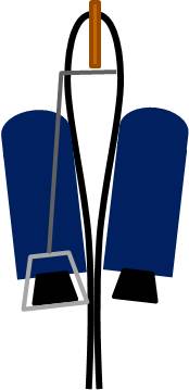

I did a quick bit of research. The clamps you illustrate is/are a French Clamps used by harness-makers. Only one arm is hinged and there is no pressure to hold an item in the jaws apart from leg pressure. I haven't found anyone to take a photo of me but I have hashed out a quick diagram (pardon the quality) that shows how they are held. By using it upright (or nearly upright) I reduce back-ache and can see what I'm doing on both sides of the leather by moving my head a bit without having to reposition the clams to see the back side.
The clams are held vertically between the legs. This means that the leather is held vertically. You can lean the clams to one side or the other by about 40 dgrees. I see in the picture that one of the jaws folds but I presume this is not to change the angle of the clams in use but to allow one jaw to move relative to the other so that they will open and close. I would say from the photograph that, if I was using those clams, I would sit on a higher chair so that the clams are vertical. I do not always need to see the stitch holes as I use a stitch pricker and can usually feel where the next stitch is to be. The position that chap is in looks awfully uncomfortable. I will try and find someone to take a photo of me using my clams so you can see what I mean. Gary

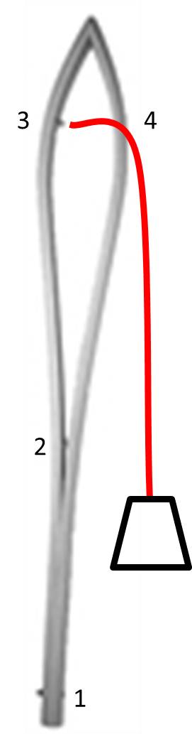

Chris, I use a saddler's clam (or clams or clamps or clamp - depends who you talk to). They are used with the base on the floor and the jaws are held between the legs with one jaw to left and one to the right. The leather is held in the jaws vertically so you have to stab and stitch horizontally left to right (or vice versa). You'll need to sit on a high chair or stool to get the leather at a comfortable working height. I'm not sure about the set you are looking at but traditionally, saddler's clams were made of barrel staves - hence the shape - and are held together at the base ('1' in the attached photo) by a bolt. There is a bolt with a wing nut part way up the clams (at '2') that allows adjustment of the jaws' tension. At '3' there may be a staple on the inside of the jaw to which an adjustable strap may be attached and passed through a corresponding hole at '4' and then down to a stirrup which allows you to adjust jaw tension with your foot and can keep the clam more stable. I keep a stack of odd-shaped bits of wood, plastic and foam nearby so I can put them inside anything I'm sewing that isn't a plain, flat shape which helps hold them in the jaws. You can also make or buy additional smaller clams that fit inside the jaws to allow you to sew rounds or keepers. You may want to dress the inside of the jaws so they don't mark any leather you are sewing. Hope that's of some help. Gary
