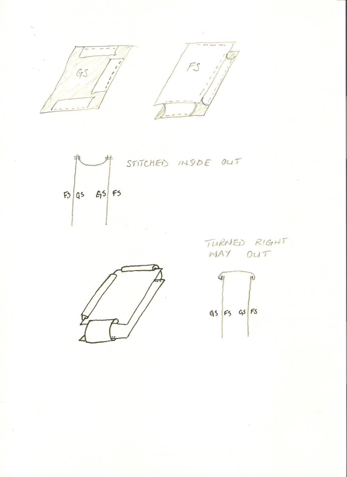

If it is not possible to sew it the way you have envisaged it, fiddle about until you find a way the pieces will go together to get a result that is possible. Have a look at the scan below as I have tried to explain my intent. You will be able to stitch it this way though the pieces of elastic will not be laid in exactly the way you wanted them in the first place. Be willing to sacrifice a bit of time, leather, elastic and thread to find out what works and what doesn't - that's how most people here have gained their understanding of their craft. All the responses here have given you answers you need if not the answer you want. FS=Flesh side GS = Grain side
Sew it inside out, edge to edge, then turn it the right way out.
