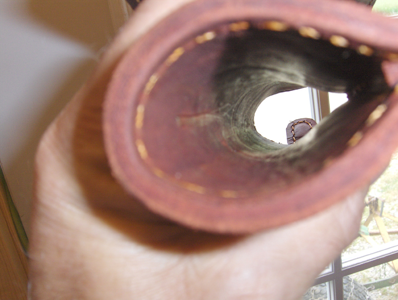

Actually, Joe, . . . turning it over was far easier than sewing it. I couldn't cement it because I didn't want the cement to show if I somehow missed where I needed to stitch it. So, . . . I'm holding the sides straight up, . . . turning the corner with my left hand, . . . pulling the Boss handle with my right hand, . . . balancing the rest of the bag on my left knee, . . . and all the while blinking and squinting, . . . hoping that what I'm seeing is what I'll get when it is all done. Half baked funny now, . . . sure wasn't then. Took it to my deep sink and soaked it wet, . . . fully the whole thing, . . . turned it inside out just like a dirty old cotton sock off my left foot. Had to play with the seam to get it straight, . . . but no biggee. That's why next time the bottom is the last thing going down. I've got some chrome brown leather left over from a pair of chaps, . . . probably gonna turn into a hand bag. May God bless, Dwight -

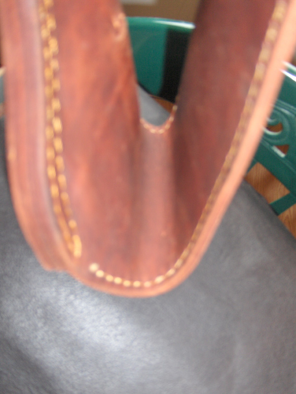

Well, Monica, . . . up close and in person, . . . the purse did not turn out as well as I had wanted. I had trouble with several items, . . . mostly of my own making, sad to say, . . . but leather working is kind of like fishing, . . . at the end of the day, they are either keepers or you pitch em back, . . . I'll keep this one. Especially since it is the first one like this I've ever done. The body is basically 3/4 veggie tan, . . . whole thing is sewn on a Boss, . . . 346 thread, . . . Desert Tan water base dye for the body, . . . British tan for the belts. Inside dividers are of the same 3/4 veggie tan, . . . belt is 7/8 veggie tan. The next one of these I do, . . . the bottom will be sewn on last, . . . that was my BIG mistake, . . . and I thought about it for a long while before i took the plunge, . . . Anyway, . . . a good learning experience. Thanks all for the good words and the encouragement. May God bless, Dwight -
