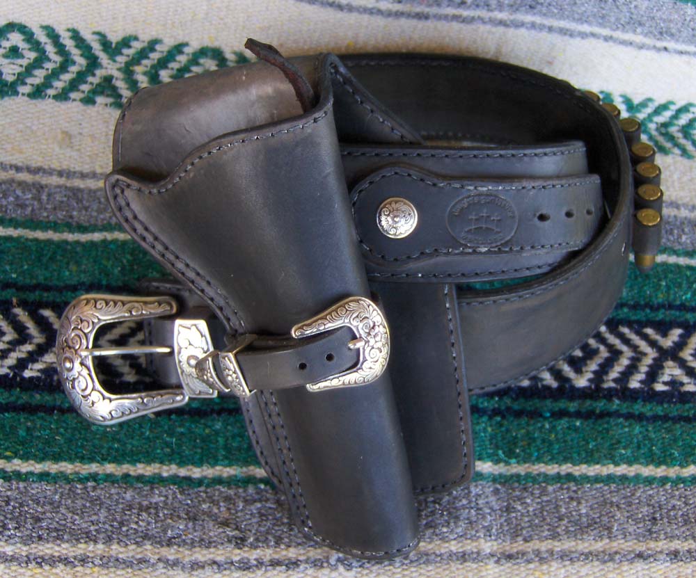

First Gunfighter Stitch Belt
Dwight replied to Red Cent's topic in Gun Holsters, Rifle Slings and Knife Sheathes
Looks good, . . . but then again, . . . I'm partial, . . . always did like that design. May God bless, Dwight -
