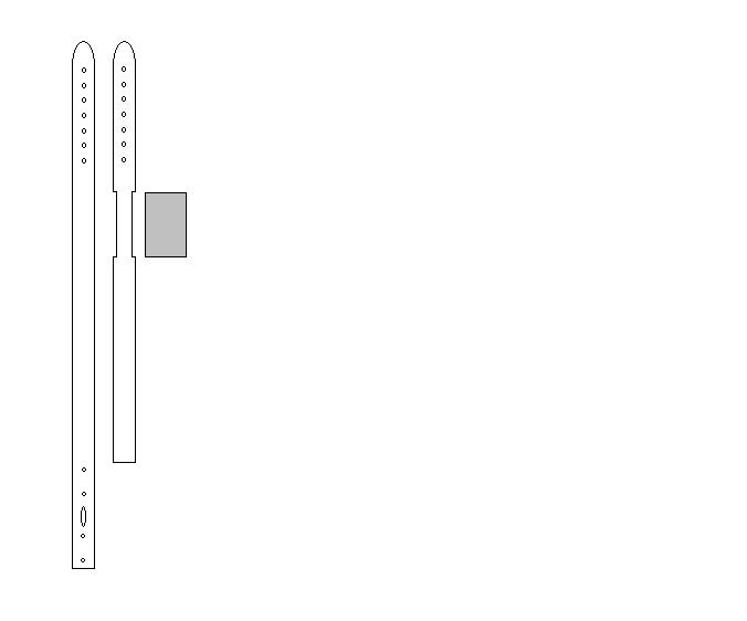

I like to make sure I give my customer's their money's worth, . . . and sometimes it is just a little thing. On my belts, . . . I use one inch spacing, . . . and I give them 7 holes. Doesn't sound like much, . . . but a 5 hole belt at 3/4 spacing only gives that customer a 1 1/2 inch movement either way, . . . mine gives them 3 inches, . . . fully double. Just my way of doing things, . . . and not everyone will agree, . . . and that's OK, . . . May God bless, Dwight -
If you have to do it, . . . end one thread and start the other between the layers. That is the only way of making it truly invisible that I know of. Sometimes a thread will break or I run out of thread in the bobbin, . . . and if it happens at the tongue end, . . . I'll camouflage it in the "going around the corner" of the belt. Otherwise I just pull it all out and start over. May God bless, Dwight

Camano Ridge has the way I do it, . . . and if they don't goof up the measurement, . . . it ALWAYS works. I knew a guy once who wore "36" trousers. When we measured HIM for the belt, . . . turned out to be a 41. He had worn those jeans enough to stretch them all the way out to where the 36 was just numbers, . . . nothing near a size. I just sent off a $200 belt rig, . . . measured Camano's way, . . . note came back with big thank you, . . . "It fit perfect". Try using some "formula", . . . make a couple of those $200 rigs that don't fit and you'll see that there really is a good way, . . . and it all has to do with measurement. May God bless, Dwight -
