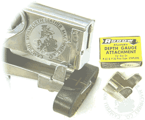

What brand and model Stapler do you use?
CampbellRandall replied to GrampaJoel's topic in Leather Tools
GrampaJoel, LT-P356 P35 3/8 inch STAPLES The P35 uses a 3/8" wide staple and will set a flat crown. Many of our customers use it for belt loops. Regards, Dan Naegle -
Here is another option LT-P35 P35 EXTRA HEAVY DUTY PLIER TYPE STAPLER -
