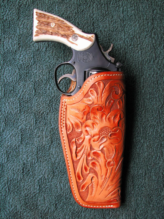

As it happens, I have made a few (thousand) Threepersons' style holsters, including some for the 1911-style pistols. Attached are some photos showing one made with hand-carving based upon the original pattern, elk suede lining, and traditional thong retention. Basic envelope-style construction with welted seam and folded belt loop, mid-ride height, modest forward cant, when made along the lines of old Tom's personal holster. Many variations have been produced by most 20th Century holster makers, and the general design can readily be seen in a number of products still offered by several companies. My personal specialty has been recreating the original design with the original carving pattern (done for me by a very talented artist in leather). The Threepersons' style has always been a favorite of mine. Best regards. -

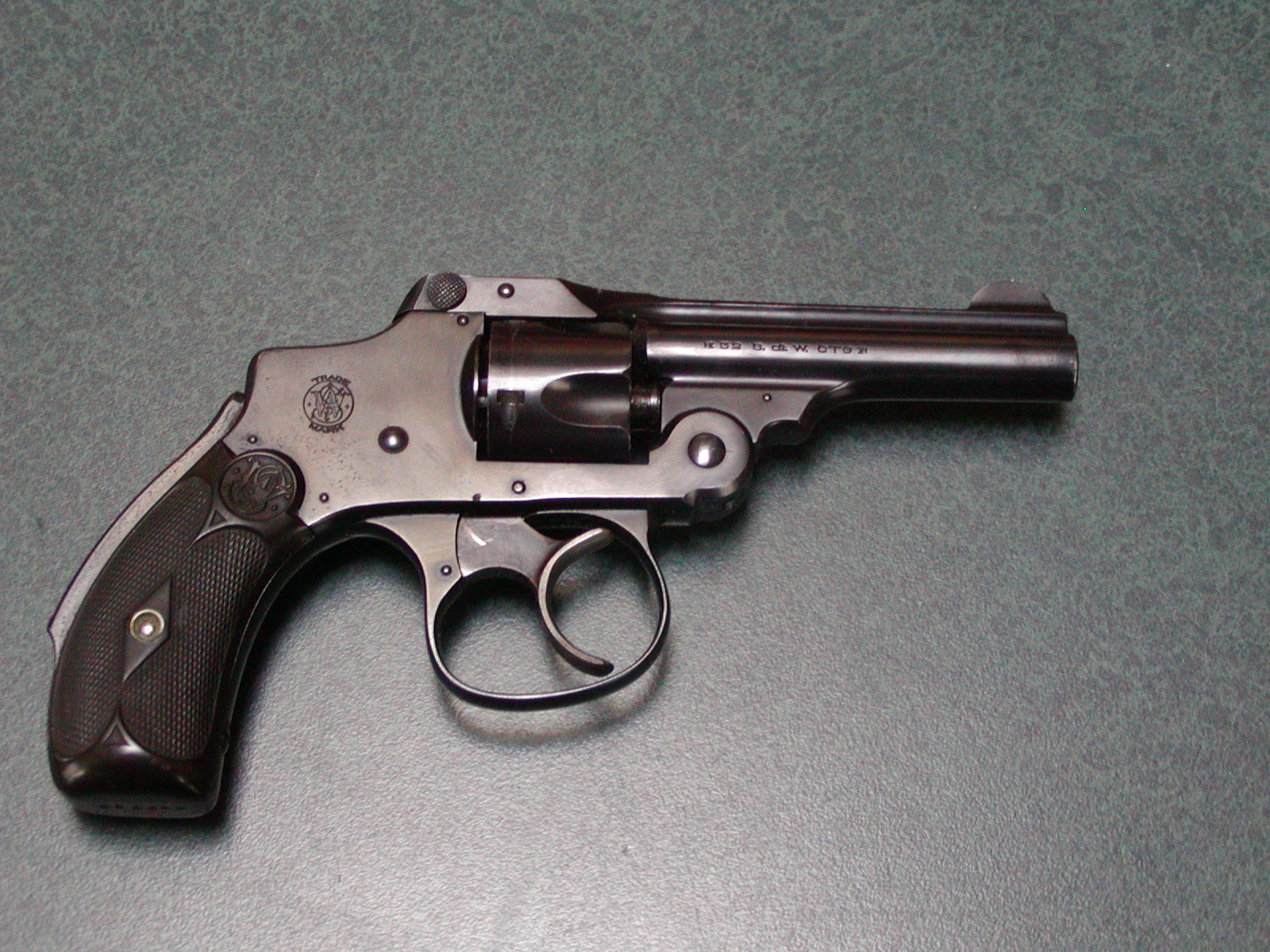

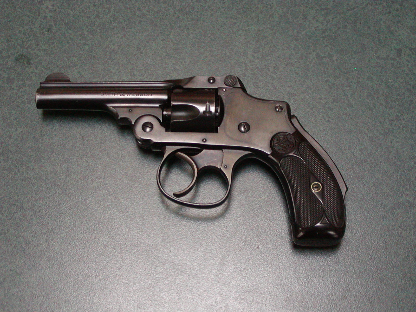

My friend John mentioned to me some time back that he had his father's old revolver, wanted a holster for it, but had never been able to find anything. Now, John is in his late 70's, so his father's old revolver was likely to be a real old timer, so I asked to see it. In due course, John brought it to me. Smith & Wesson hammerless "lemon squeezer" (Model 1-1/2 Safety Hammerless, 3rd Model) double action revolver, caliber .32 S&W. Probably made between about 1890 and 1920. State of the art gentleman's vest pocket revolver, back in the day! And much to my surprise, the revolver shows almost no wear at all! Blued finish is without significant blemish, case-hardened trigger in near-perfect condition, bore and chambers could be unfired condition. Very few of this type remain in such fine condition. It is always a treat to see some of the old time pieces. I explained to John that, given the condition of the piece, it is certainly a desirable collectable, that I would advise putting it away for safekeeping, and that carrying it in a holster could possibly result in finish wear. John still wanted a holster for his dad's revolver. So I made a simple belt holster for him. Hermann Oak 6-7 oz. veg-tanned. Welted seam construction. Folded belt loop. Removable retention strap with snap. A fun job! And I got to keep a nice old S&W around for a week or so.
