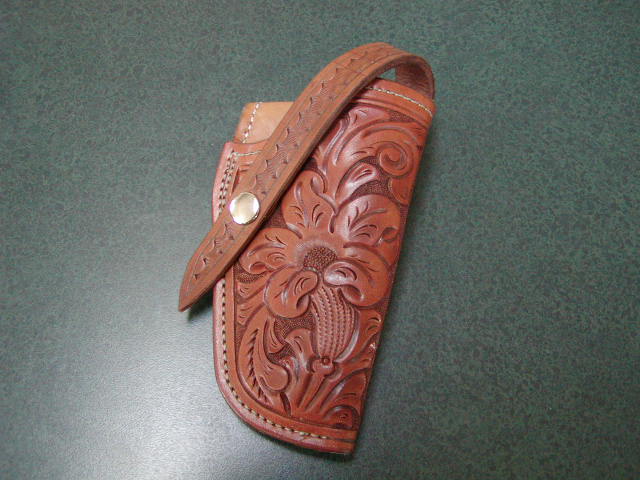

I agree with Andy on this one. Rivets are fine for some applications, but stitching would be just fine for securing the strap ends. On a belt a fancy stitch pattern would be easy to do and would add a nice touch to the overall appearance. I recently completed an order for a customized Ruger .476 Linebaugh consisting of a Threepersons-style holster, belt, and cartridge slide. The slide carries five of the huge .476 cartridges and was constructed with the method discussed (slots cut for each loop, strap pushed through and wrapping around each cartridge), but I sewed the strap ends and cut them flush with the outer edges of the cartridge slide. I'll try to post some photos of that rig soon. -

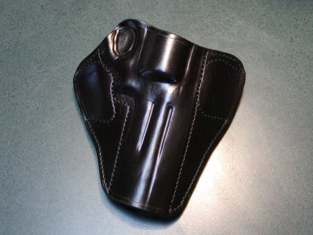

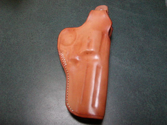

I have been very gratified by a continuing high demand for revolver holsters, and I make several holster models. Here are a few: Model 5-T strong-side belt holster. Model 5-T configured as cross-draw. Classic Threepersons-style, hand carved to the original pattern. Enhanced Pancake model. Enhanced Avenger model. -

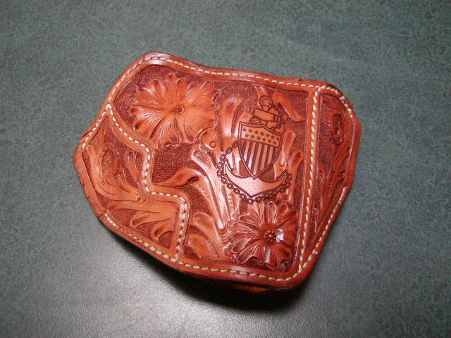

I regularly make half-a-dozen holster models with various options available to suit customer preferences. This is usually interesting enough and keeps me busy, but occasionally I like to work on something unique. Two customers recently provided some opportunities. First was a retired US Coast Guard Chief Petty Officer who requested holsters for his Colt Commander and his S&W K-frame 2.5" with full carving in the Sheridan style and incorporating the image of his CPO collar insignia. I consulted with my carver (a very talented artist) who advised that the details of the collar device would not lend themselves to hand carving, so he suggested using a laser-carved image combined with the Sheridan carving. The results are shown in the photos. I am now exploring ideas for the use of laser-engraving for military and law enforcement images (unit crests & patches, badges, etc). The possibilities are limited only by the need for a clear and concise image to be scanned into the laser's computer control. Second was a lady requiring holsters for her Springfield Armory 3" 1911 and S&W 686-P 3". Both holsters needed to provide IWB carry with cant adjustable from approx. 25 degrees to approx. 45 degrees for carry well behind the strong-side hip. Such carry angles, especially with shorter handguns, require that the handgun rides quite low. My concerns were that the revolver hammer/cylinder/recoil shield areas would be positioned so that belt pressure would prevent a smooth draw, that the hammer/rear sight might snag in the clothing during the draw; and that the semi-auto pistol would encounter similar obstacles. My approach was to utilize envelope-style basic construction, 7/8 oz. leather for the holster bodies, and 8/9 oz. leather for an extended reinforced holster mouth. This provides an extended tunnel that is well reinforced, allowing the belt to pass over the bulk of the handgun without crushing down the holster in the area that needs to remain open for a smooth draw. This results in some added bulk to the package, but it is well contained within the waistband. The forward belt attachment points are located high on the reinforced holster mouth using T-nuts mounted through the reinforcement but not into the holster interior. The rear belt attachment points (two on each holster) are located to adjust cant to the required angles, and the loop can be moved from one point to the other by removing a #6-32 screw securing the snap stud to the T-nut. The unused T-nut point is trimmed out with a screw and trim washer. On both IWB holsters about the only part of the pistol extending outside of the holster are the grip-frames, and those are fully exposed for unobstructed grip during the draw. So, a little added interest to the work over the past few weeks.
