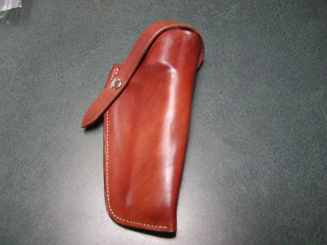

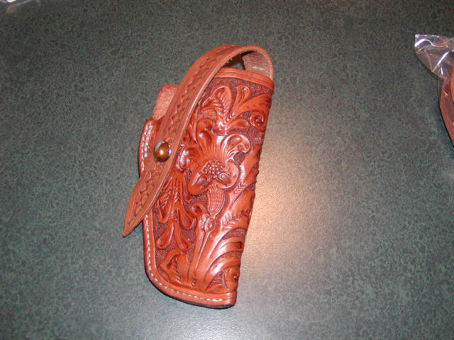

Finished my Tom Threepersons Design Holster
Lobo replied to Larry's topic in Gun Holsters, Rifle Slings and Knife Sheathes
Minor correction: Threepersons' original holsters were made by S.D. Myres Saddlery Company. The design was picked up by just about every other holster maker in the country during the 20th Century, and its influence can be seen in many holsters of current manufacture. -

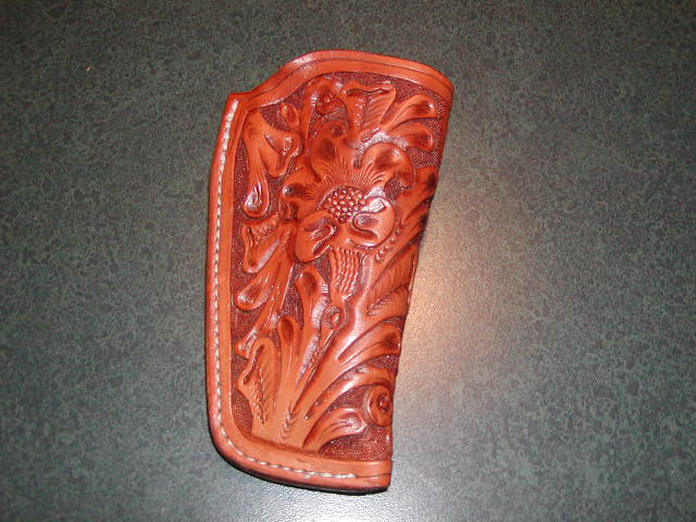

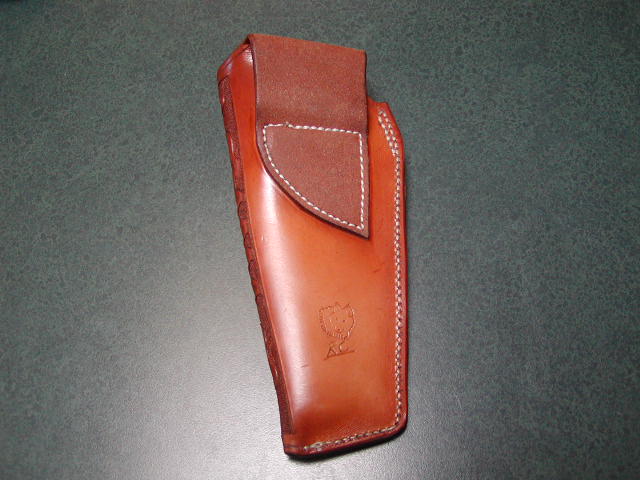

The Threepersons-style holster features a welted seam (a "welt" is an additional thickness of leather sewn between the front and rear holster panels which reinforces seam strength and allows for easier fitting of the holster to the handgun). The second stitch line at the upper portion of the seam is simply meant to reinforce the seam at a stress point (where the handgun is inserted and withdrawn). I found a couple of photos showing the backs of Threepersons-style holsters, and have included the fronts for reference as well. The holster you have shown was made by El Paso Saddlery, and features their unique method of sewing the holster lining (over the mouth of the holster).

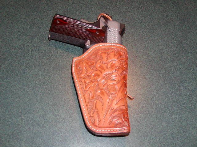

The Threepersons holster project continues to be popular, and the Christmas season has generated several orders for the original-pattern hand-carved holsters. One customer ordered two matching holsters for his wife and daughter, fitted for their matching S&W J-frame .357 magnum revolvers. The original Threepersons-style was modified to incorporate a steel-reinforced thumb-break retention. The artist who does my carving work did an amazing job in matching the patterns on the two pieces! Considering that this style of carving is done entirely by hand, with each cut and modeling application done individually, the results are a tribute to the creating artist! I can't help but think about all the money I've wasted on jewelry and other nonsense at Christmas! But, I've never had a wife and daughter who carried matching .357 Magnums! Also on this week's schedule were carved Threepersons-style holsters for a 3-inch N-frame S&W with strap retention, a 4-inch L-frame S&W with strap retention, and an open-top original style for the Browning Hi Power pistol. While the majority of my production work is intended for concealed carry applications (never intended to be seen!), I genuinely enjoy making these original-style Threepersons holsters with carving to the original design.

Exceptionally nice workmanship. It appears that your inner panel is assembled smooth-side in? I like the effect of the dye work.

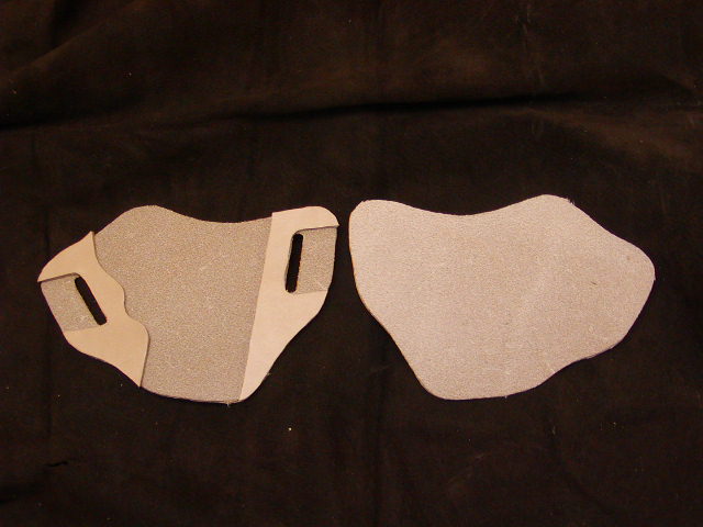

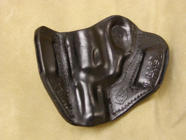

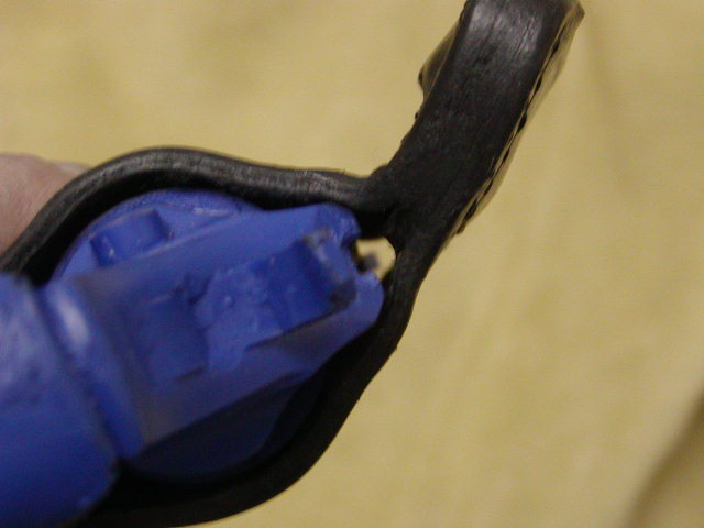

Enhanced Pancake-style holster
Lobo replied to Lobo's topic in Gun Holsters, Rifle Slings and Knife Sheathes
Thank you for your input. I will pay special attention to the testers' comments on these points. -
Thanks, Mike. It probably sounds like I am congratulating myself when I say it, but I believe that this is a considerable improvement over the traditional two-panel pancake style. Once I have the reviews in hand I intend to make any adjustments called for to the design and offer this as an option to my customers. Best regards.
