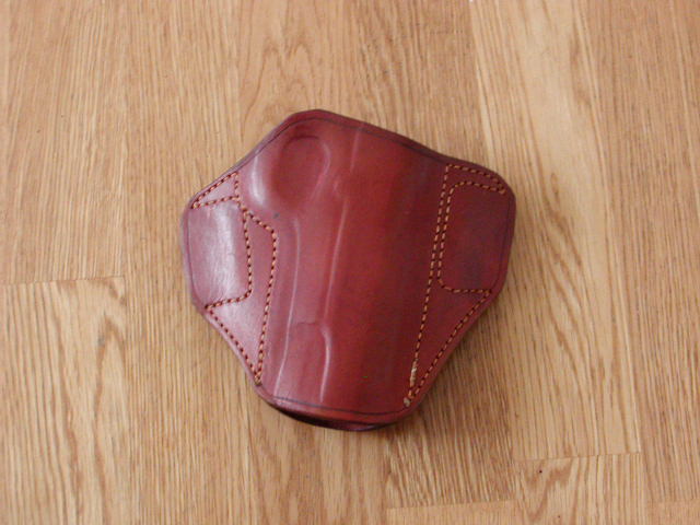

Prototype, variation on the Avenger style
Lobo replied to Lobo's topic in Gun Holsters, Rifle Slings and Knife Sheathes
Thank you, 303brit. By coincidence, just yesterday I completed one for the Glock 19 with neutral cant. I have added the "Enhanced Avenger" and "Enhanced Pancake" models to my product line, and interest has been very good. These two new models now account for 30% of orders since the first of this year. Attached photos show the Enhanced Avenger with mouth reinforcement for the Colt Commander and Enhanced Pancake for the 1911, recently shipped out. -
