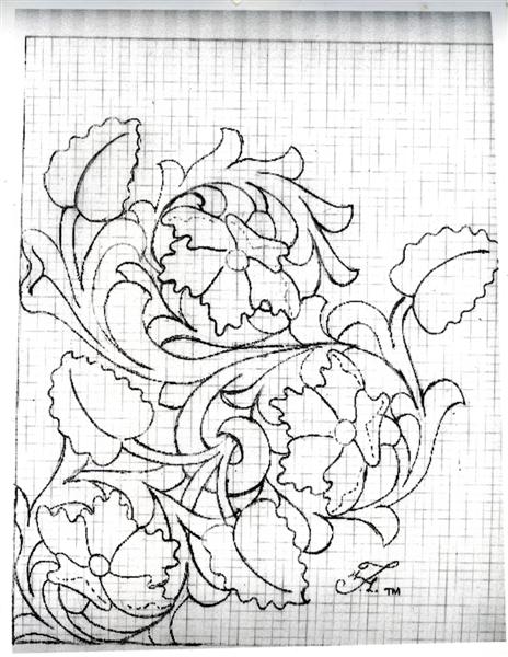

Marlon.....Great job for the first time out! David gave you some really great comments. I wanted to add to them, but I decided to do something else instead. I've taken your flowers and leaves and the general pattern layout and re-defined the stemwork. I thought it would be easier to show, than to explain the "flow" of the stemwork. As David pointed out, there were areas where the pattern seemed disconnected...in other words it was difficult to see how the pattern got from A to B. It seems to just appear out of nowhere. There was also an issue of "scale" as well. You'll see in my stemwork that the lines defining the petals in the stem are long and help to create the "flow". In addition I greatly reduced the size of the petals and created more of them, making it is easier to follow how the stemwork travels around the major components which are the flowers and the leaves. I thinks this also makes the pattern more pleasing to the eye (I hope anyway!). I highly recommend that you get a copy of "Sheridan Style Carving" by Bob Likewise. I think it is invaluable in learning to design your own patterns. In it, Bill Gardner takes you through the fundamentals of Sheridan Style design and there are a lot photos to study! Well worth the money! Keep at it, you made an excellent first attempt and I hope this will be helpful to you! Bob
