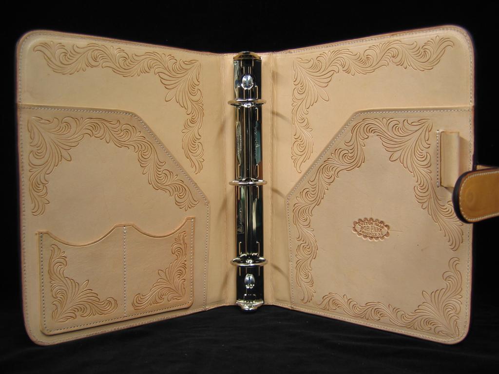

Here is a project just completed for a customer. It's a standard 5-1/2"x 8-1/2" organizer with a 1" three ring binder and a tab closure. It's constructed with 7/8 oz Herman Oak for the front and back, 2 oz for the interior and a piece of 7/8 was split down to 5/6 oz for the binder. Stiffeners were installed under the lining to give it more rigidity. After the tooling was completed and the background was dyed, it was oiled, antiqued and sealed with Neat-Lac. The interior is finger carved and sealed with Tan-Kote. I used a French edger to "let in" the tab to the back leaf so that it is sandwiched between the back and the lining and does not create an annnoying bump on the back of the organizer. I also buried the snap inside the tab for a little cleaner look. Everything was glued and then sewn with Rice #99 Nylon thread, top & bottom, at about 9 stitches per inch. I appreciate all critiques and comments!

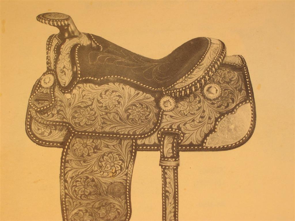

Kustom & skipj, I will try to answer your questions regarding Porters style tooling. It is not as easy as one would think! As I'm sure you're aware, Porters was a very large saddle making company located in Phoenix, AZ., where it thrived for many years. Consequently hundreds of saddlemakers/toolers worked in their shop at one time or another, each perpetuating the Porter style of tooling. Old style Porter tooling is most represented by a large flower at the end of a stem which flows out of another flower or stem. There is a logical flow in the pattern where a stem starts, grows into a flower which is continued by another stem & flower, etc. Here are photos of Porter saddles from their 1931 catalog: As time evolved so did their tooling patterns. You will notice in the photo on the left, that the pattern now flows in interconnected circles, as opposed to the one on the right, which is flowing in a general circle. These photos were taken from their catalog which was being used in the early and mid 1960's: When considering Porter style tooling you must also recognize Bill Porters Saddle Shop where the Porter traditions were continued into the 1980's, long after Porters had closed their doors. In the next two photos you will see the Payson pattern (left), identical to one of the saddles from the 1965 photo and a Deer Valley pattern (right) which is very close to, and might even be confused with the Sheridan style. These two photo's came from a Bill Porters Saddle Shop catalog used in the 1960's, 70's and 80's: So here are six examples of Porter style tooling and you can see the evolution to what is now considered Sheridan sytle tooling. What I see published and called Porter style, today, mostly are those patterns as represented by the 1965 photo's, largely because of Ray Pohja's influence, as he is internationally known as a Porter style tooler. I find this particularly interesting because he was primarily responsible for reducing the size of the Porters patterns into what Bill Porters Saddle Shop, produced, as represented by the Deer Valley pattern. Ray designed a pattern known as the Small Payson, where the Payson flowers were the same size as the flowers in the Deer Valley pattern. I don't know, but suspect that Ray may also have designed the Deer Valley pattern. The Small Payson and the Deer Valley were Bill Porters most popular patterns! How do I know all of this you ask?...................Because I tooled for both Shops !.....................hope this helps to answer your questions!
