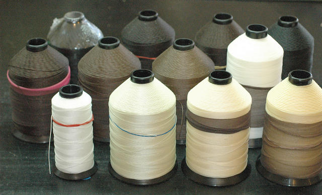

Greetings, I sold my Tippmann Boss sewing machine and another sewing machine and am cleaning out my thread stock. The following threads are available: Item Manufacture Type Size Color Quanity 1. Tippmann Nylon 207 Black 18.0 oz 2. Rice Nylon 415 Dk Brw #451 18.8 oz 3. Tippmann Nylon 207 Dk Brw #451 18.7 oz 4. Rice Nylon 415 Black 16.9 oz (SOLD)5. Rice Nylon 277 Dk Brw #451 16.9 oz 6. Tippmann Nylon 277 Med Brw #541 20.2 oz 7. Tippmann Nylon 207 Med Brw #541 18.6 oz 8. American&Efird Poly 92 White 20.2 oz 9. Tippmann Nylon 277 White 5.4 oz (SOLD)10. Rice Nylon 207 Straw #7861 17.7 oz 11. Tippmann Nylon 277 Straw #7861 17.7 oz (SOLD)12. Rice Nylon 415 Straw #7861 16.6 oz Cost is $19 per spool (except #9 which is $5) plus shipping (I can get 3 spools into a USPS 2-3 Priority Service Flat Rate Box for $11) The picture shows the items numbered left to right, back to front: 1 2 3 4 5 6 7 8 9 10 11 12 Bob Stelmack www.pslac.org

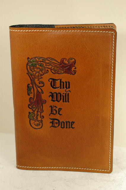

I use Tandy's Eco-Flo Hi-Lite Stain Chestnut Tan http://www.tandyleatherfactory.com/en-usd/home/department/leather-dye/2608-04.aspx Here is an example: I don't use it like the directions say. I flood the carving with the dye. Move it around for a good coverage. Wipe it off with circular motions with a folded paper towel (so it does not removed the black from the lettering). If there are any streaks, I just leave them. Let it dry. Put on a heavy coat of Aussie Conditioner and let that dry. Wipe off the excess. Use a damp paper towel to remove any streaks and the seal with Fiebing's Leather Sheen Acrylic Spray. http://www.tandyleatherfactory.com/en-usd/home/department/leather-dye/leather-finish/2205-00.aspx Hope that helps. Bob Stelmack www.pslac.org
