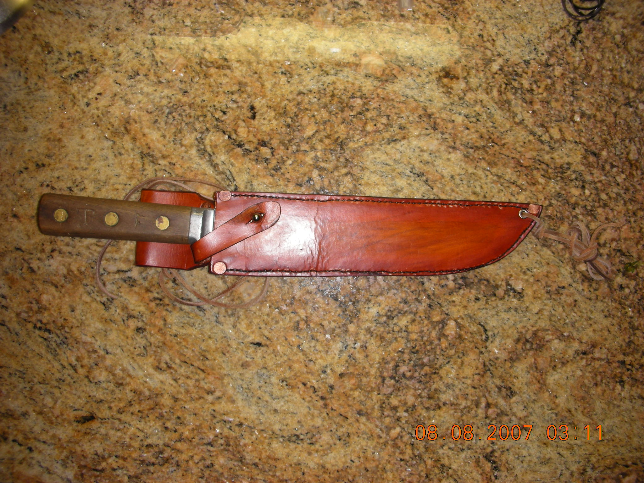

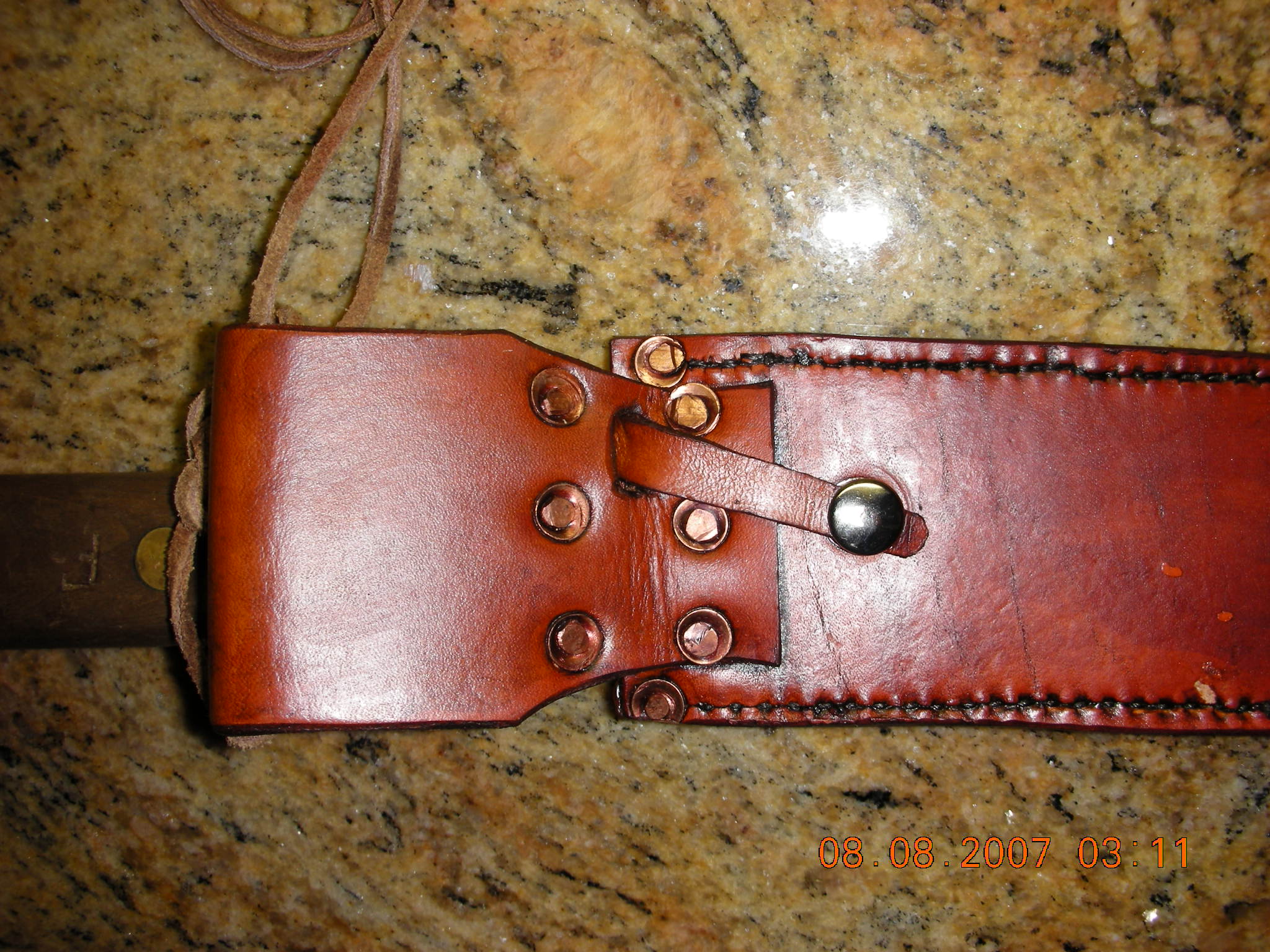

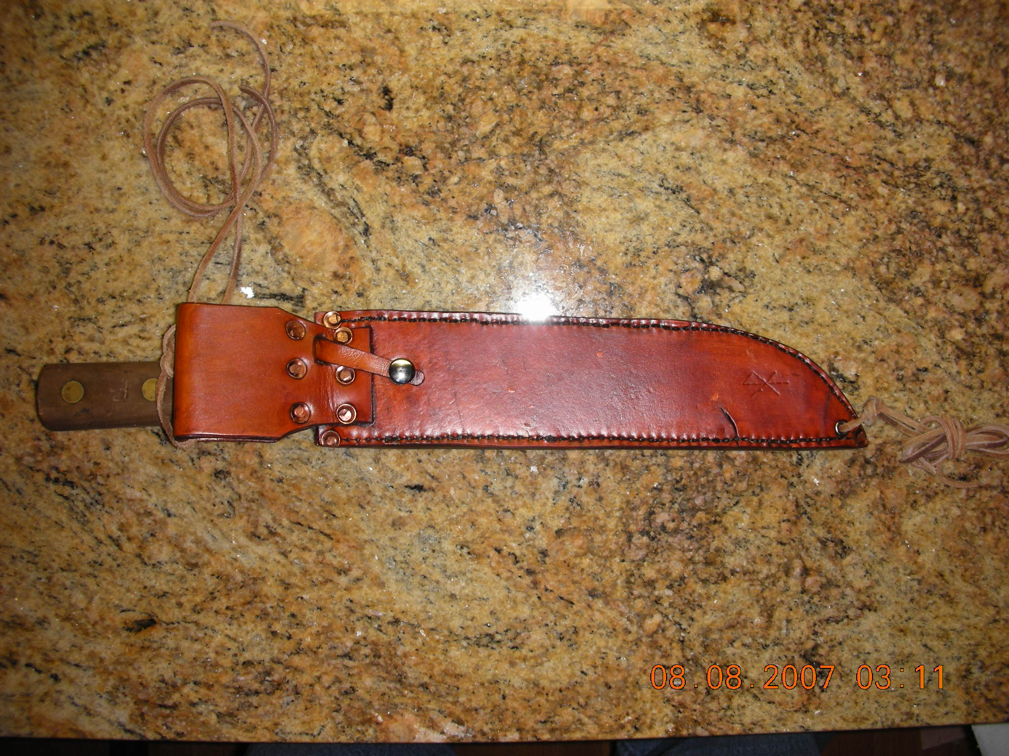

Yeah, with a sewing awl.... with the thread in it... I took one side and laid out the holes with the 4 hole punch, then added the center spacer with glue, and allowed it to dry, then added the top piece with glue and pressed together to let dry, then I used the fig/awl and mallet to go through the holes on the back through to the front to mart out he holes, then flipped over and lightly hit the 4 hole punch into the top and then sewed it up.... I then put the edges on the grinder to even them out and make them smooth... it wasnt easy... but it did the job... the glue I used was the white cement.... kinda like a thick elmers glue... -

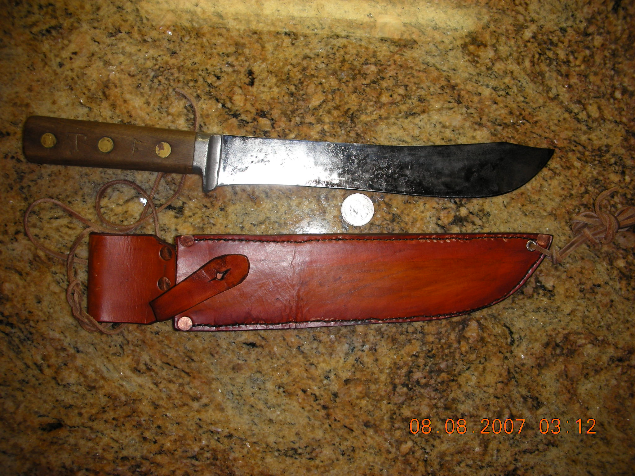

A friend from out west made it home here for about a month and brought with him a butcher knife that he has turned into a ceremonial knife and wanted me to make a sheath for it. Well, I did, and here are some pix of it....

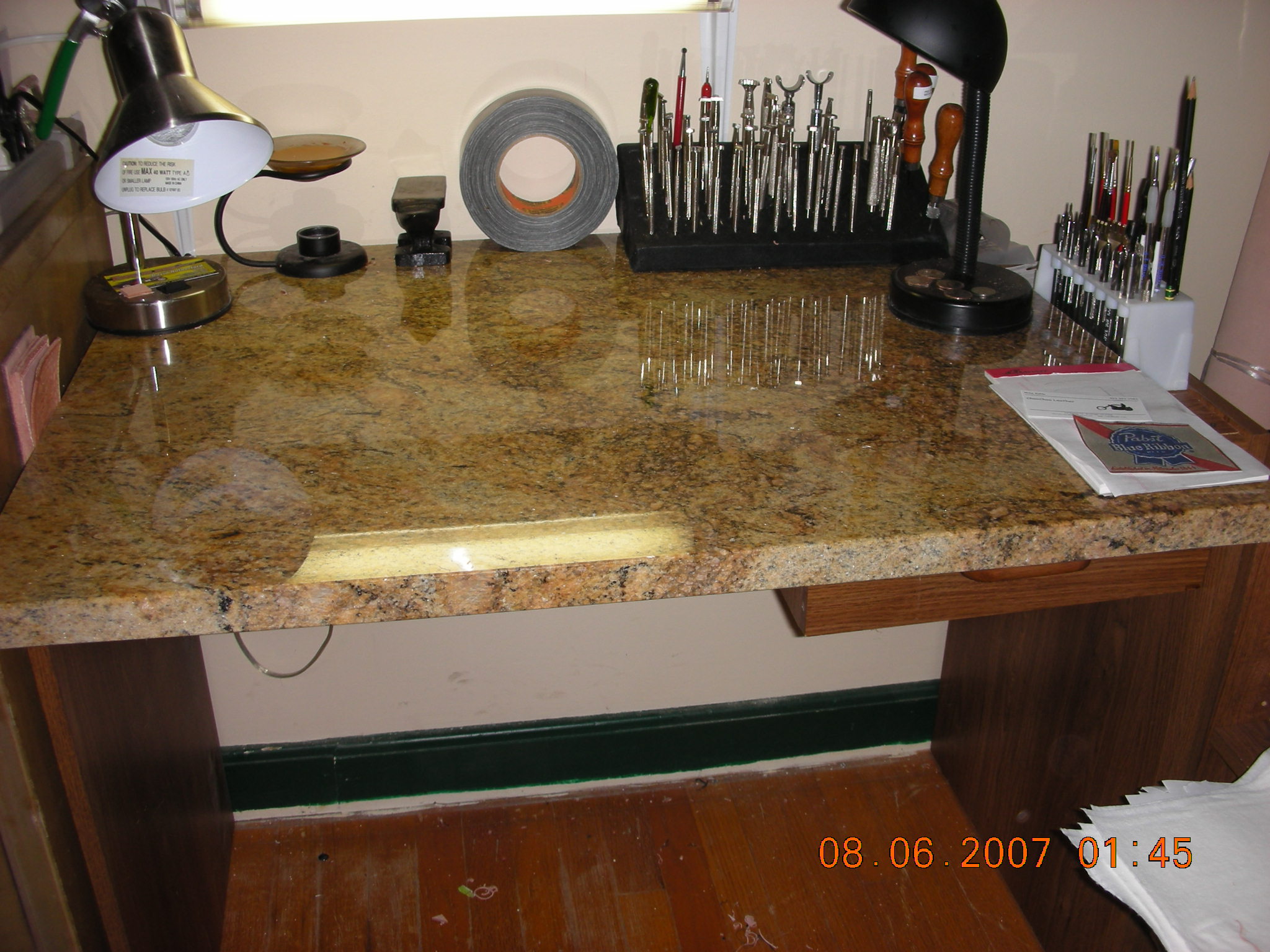

LOL, well... I did remove a few items that I like to keep close at hand on the work top.... but they add to clutter.... not mess.... And I forgot to sweep below the work top before taking the pic..... I opened to pic to see if i took a picture of a mess or what before responding.... and see some mess on the floor...

LOL, well, in my absence fromt he site, I was able to pick up a very nice piece of granite from a counter top installation/sales place here in town.... I called and stopped by alot of the monument places here and no one would admit to having scrap.... so as I was driving down the rode and saw this place I made a U turn went back and pulled into the lot, they has all kinds of scrap against the back fence, and when i got out of the car a sales guy came out and asked if he could help me.... I told him I needed a largish piece of granite to tool leather on... we went over to the scral that they had all lined up sitting on their edges and the first piece he showed me was 2 1/2' by 3' by 1 1/2".... i said that it was perfect and asked how much, expecting him to say 50 or 100 but he said it depends, do i need them to round off the edges (three edges were rough from where it had been cut from a larger piece, and one edge along the longer side was rounded) and I said no.... it is perfect the way it was... then he asked if $10 was too much.... Hell no... here is $10 cash.... wanna help me load it? LOL. We loaded it, and I gave him a card and told him if he ever needed anything leather, to call me, I would hook him up.... I got it into the house and cleared off my desk... put it on the wooden desk top and it was just wide enough but over hung the desk top by about 9 inches which i dont mind because it gave me a larger surface to work on.... I have been using it ever since.... I love it....I will get a pic to post here if I remember......
