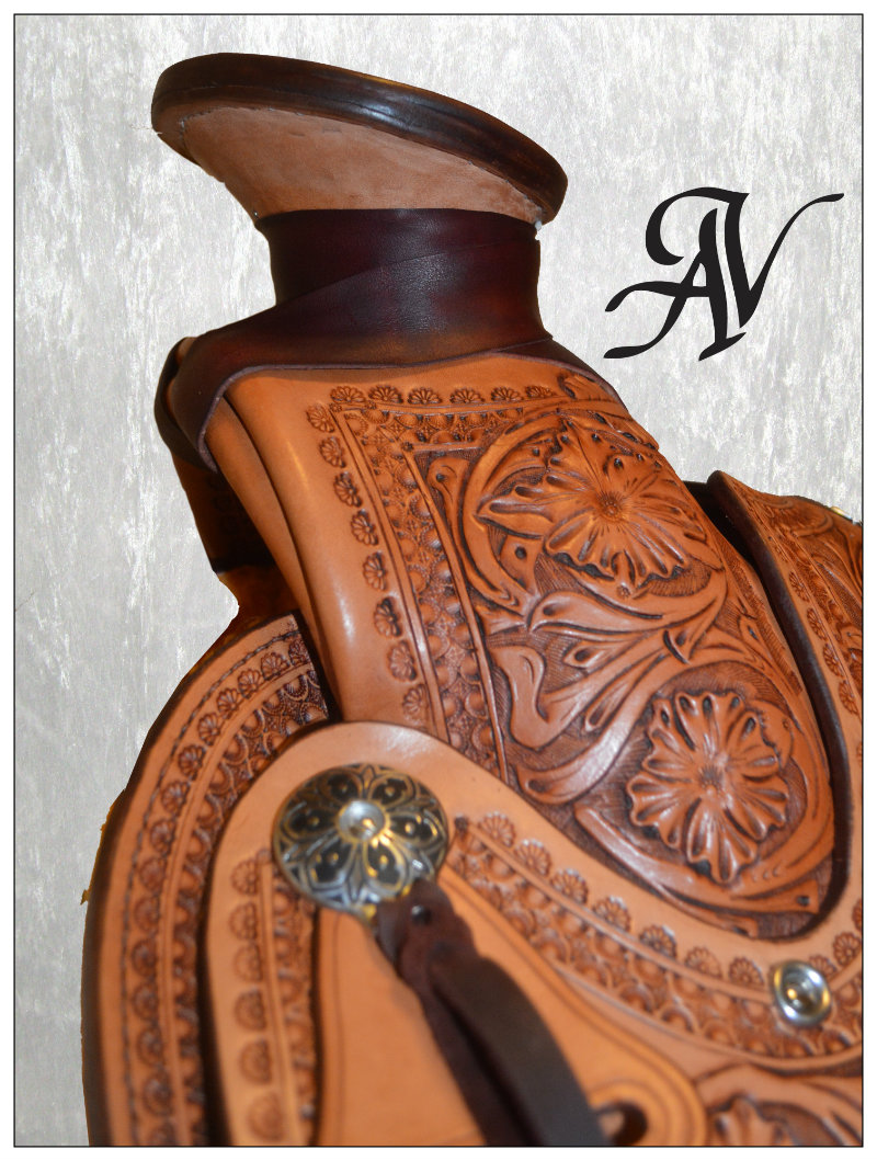

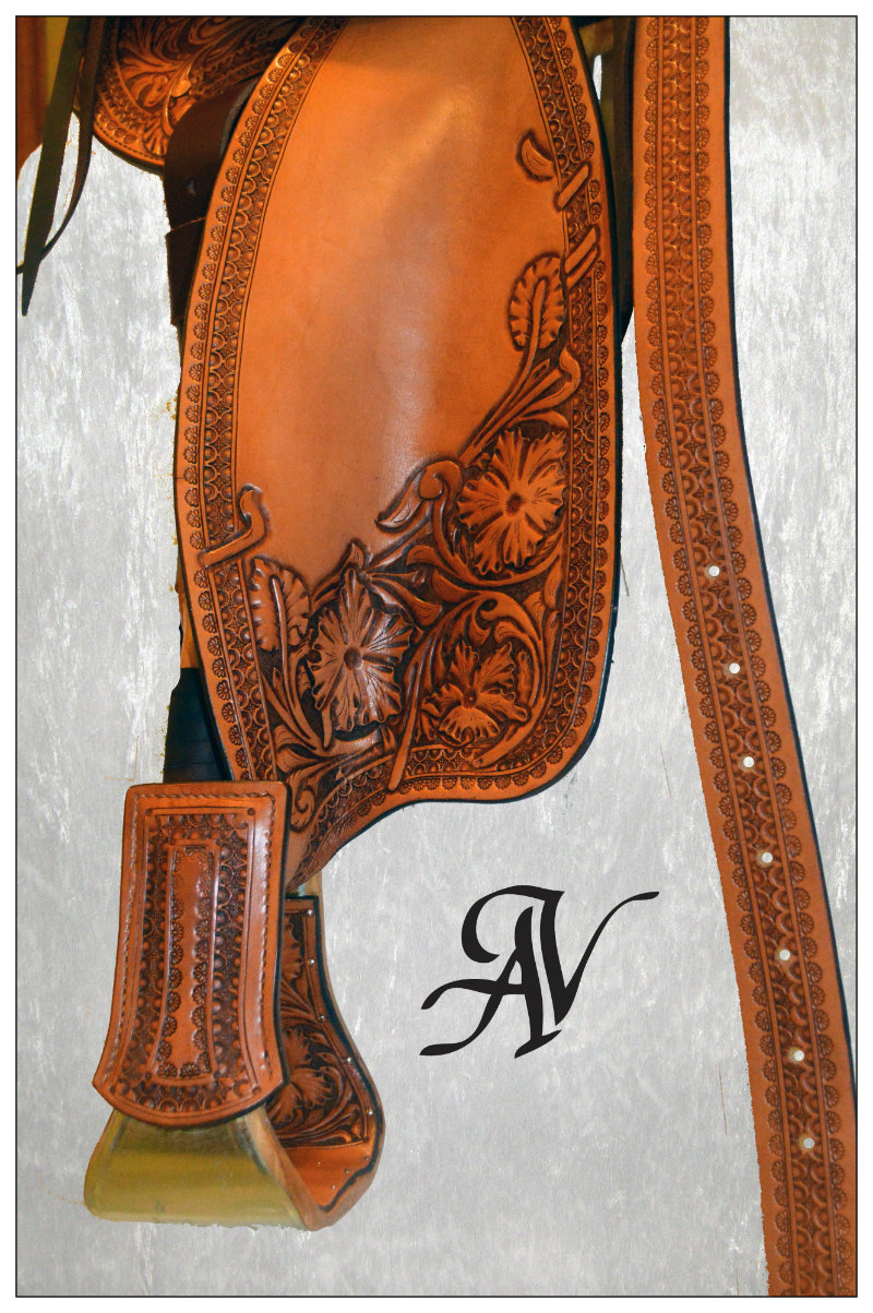

Members Chaed Posted March 23, 2013 Members Report Posted March 23, 2013 Hey guys. Some of you might know me from my other thread in Saddle Construction, Starting First Saddle Well, I guess that start has now found its end. I just finished. It's really late over here, so I'll leave you with some pics and post all the facts tomorrow. PS. Please give me your honest opinions, critisms and such! I have a list of things that I know need improvement but as a complete leathernewbie I'm proud that I've completed this! Here you go! Quote

Northmount Posted March 24, 2013 Report Posted March 24, 2013 Fantastic job. I can only wish to do that someday. For the photo #4, to get the whole photo in focus, you need to increase the depth of field by using smaller lens opening near f16 and longer exposure. The the horn and cantle can both be in focus. Tom Quote

Members Chaed Posted March 26, 2013 Author Members Report Posted March 26, 2013 Thanks all for your comments, they really made my day! Northmount - I fear I have no clue about cameras other than turning them on and pressing the button to make a picture, but as soon as I'll decipher your tip I'll try making a new picture! And Saddle #2 is already in the mental planning stages. Quote
Northmount Posted March 27, 2013 Report Posted March 27, 2013 Northmount - I fear I have no clue about cameras other than turning them on and pressing the button to make a picture, but as soon as I'll decipher your tip I'll try making a new picture! Here are a few links that may help you with depth of field. Mostly, get more light on the subject if you can, but there is more to it that can be done. http://digital-photography-school.com/aperture http://digital-photography-school.com/a-deeper-look-into-depth-of-field http://digital-photography-school.com/overcoming-depth-of-field-problems-in-portraits Good luck on saddle #2. Tom Quote
Frank Posted April 2, 2013 Report Posted April 2, 2013 I have one suggestion that really has nothing to do with the saddle. An old time saddle maker gave me some food for thought on this one. The Keeper buckle on your flank cinch or small Dees for those who use them instead, should be on both sides of the flank cinch. That way, if you have a tear out while riding, you can turn the flank cinch around and use the buckle or Dee on the other side and it will keep you in the game. Frank Quote
