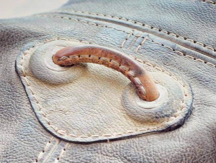

  3. Hello all, Can someone give me a step-by-step guide on how to create this small detail? You might overlook it at first, but when you look closer you can see how beautifully the leather has been worked. The passage is slightly raised, creating a nice protrusion. I would like to know how to achieve this effect, and also how the leather loop is securely fastened on the inside. Thanks in advance, Bert
