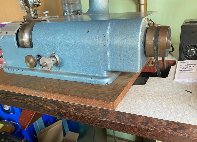

My Fortuna skiver is mounted on an old flat-bed sewing machine table. The huge cut-out of the flatbed was partially covered with an 18mm (3/4") chipboard, screwed on the original table top and with a cutout for the skived leather bits to fall down through. The Fortuna is hinge-mounted on top of this chipboard.

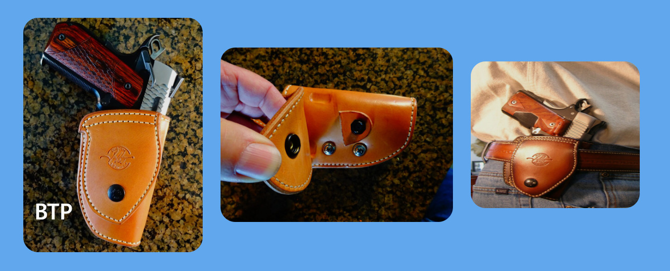

Below is a sreenshot from jeffreycustomleather.com of a holster they offer that rides between the belt and the pants. I'm wondering if anyone has made or used something along these lines. I'm going to see what I can engineer. For us fat guys, an OWB holster tends to tip out at the top. At least for this fat guy. I could see something like this being advantageous. Probably need to keep the mouth above the belt so the mouth doesn't crush when the gun is drawn. Galco offers one: https://www.galcogunleather.com/jak-slide-2-0-belt-holster_8_1176_1493.html A search for the phrase "Holster between the belt and pants" turns up some discussion around the net.

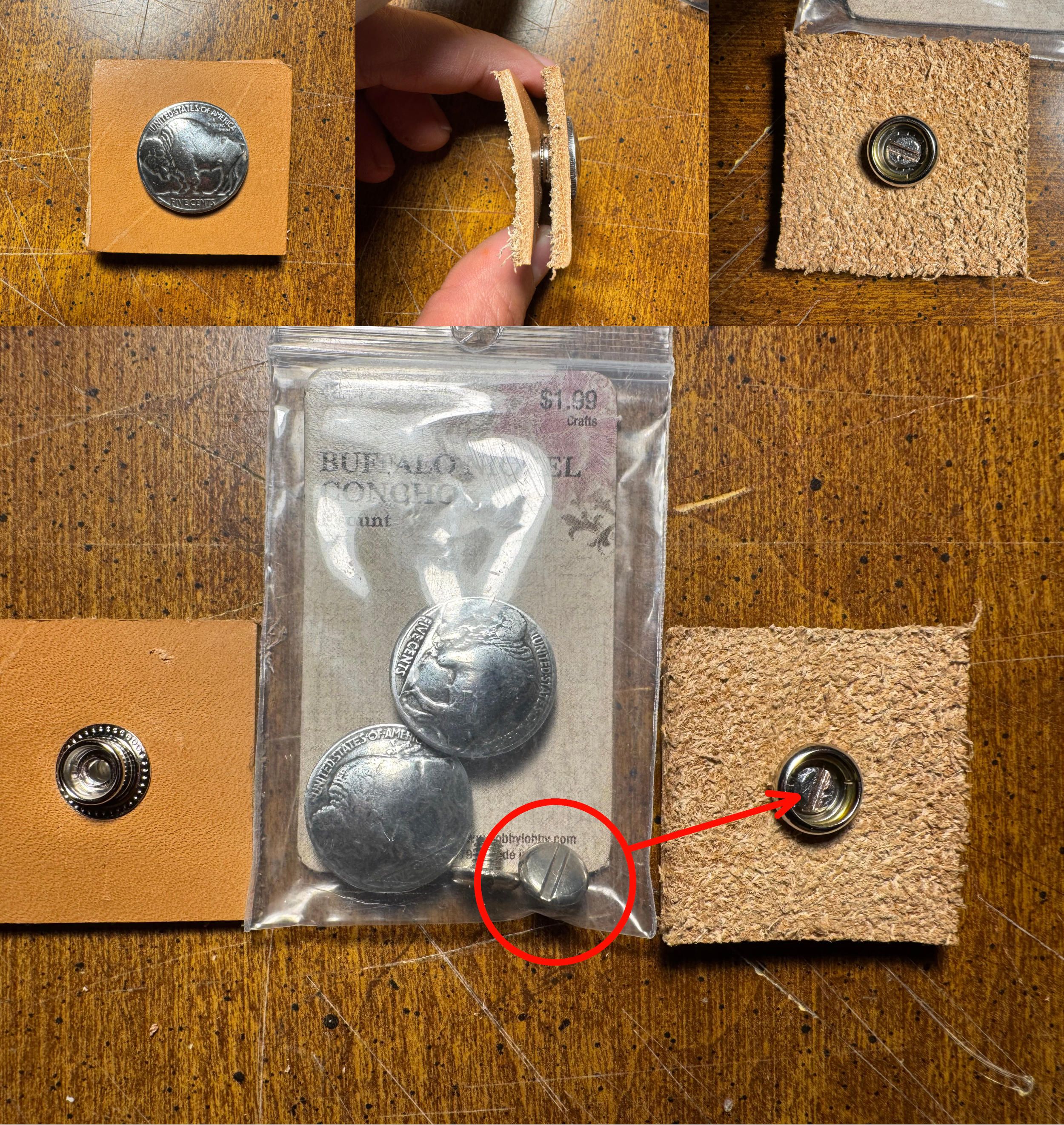

You ever see a cool concho that you wish was a snap? I ground down the outer head of the concho screw to fit inside the snap head with a bench grinder and some filing. All it would need is a small drop of red locktight to make it permanent. This is going on the next knife sheath I make.

I often go to a industrial sewing machine shop and buy an old sewing machine frame with the pedal setup. The old sewing machine table frames are so much better as they were constructed with heavier real metal. Then go to your local hardware depot and pickup two pieces of 3/4" plywood then glue / clamp them together. From there you could get fancy and put a pretty laminated top on. The standard kitchen counter typically is only is about 3/4" thick and constructed more often with press board. For the weight I would recommend going with the standard 1 1/2" thickness. kgg

Why wouldn't just a piece of kitchen countertop work? A nice little backsplash might be handy.

Hi folks. I bought a Fortuna 801 bell skiver clone with servo motor, but without a table. Of course the problem I have now is finding a table and pedal set up that I can set it up on. I've seen industrial sewing machine tables on eBay with cut outs for various sewing machine models. But none for a bell skiver. I'd be happy with a blank tabletop sewing table that I can cut the appropriate hole in if necessary. Does anyone have any leads on where a person might get such a thing?
