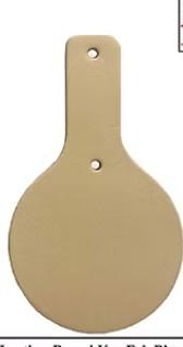

I recently picked up four Indian Head nickles at an auction, got a good price for them. I was thinking about mounting them in a key fob blank. They measure about 7/8 of on inch in diameter. I was thinking of cutting a 3/4 inch hole in the center of two blanks. Then glue the two together with the nickle in the middle. Then stitch around it. I belong to a treasure hunting club and it would make a great gift or auction item. So my question is, what is the best way to cut the 3/4 inch hole? I've been searching on google, and there are plenty of cheap punch's. I do have a 5w laser engraver I could use. But I wanted to get your thoughts about this.

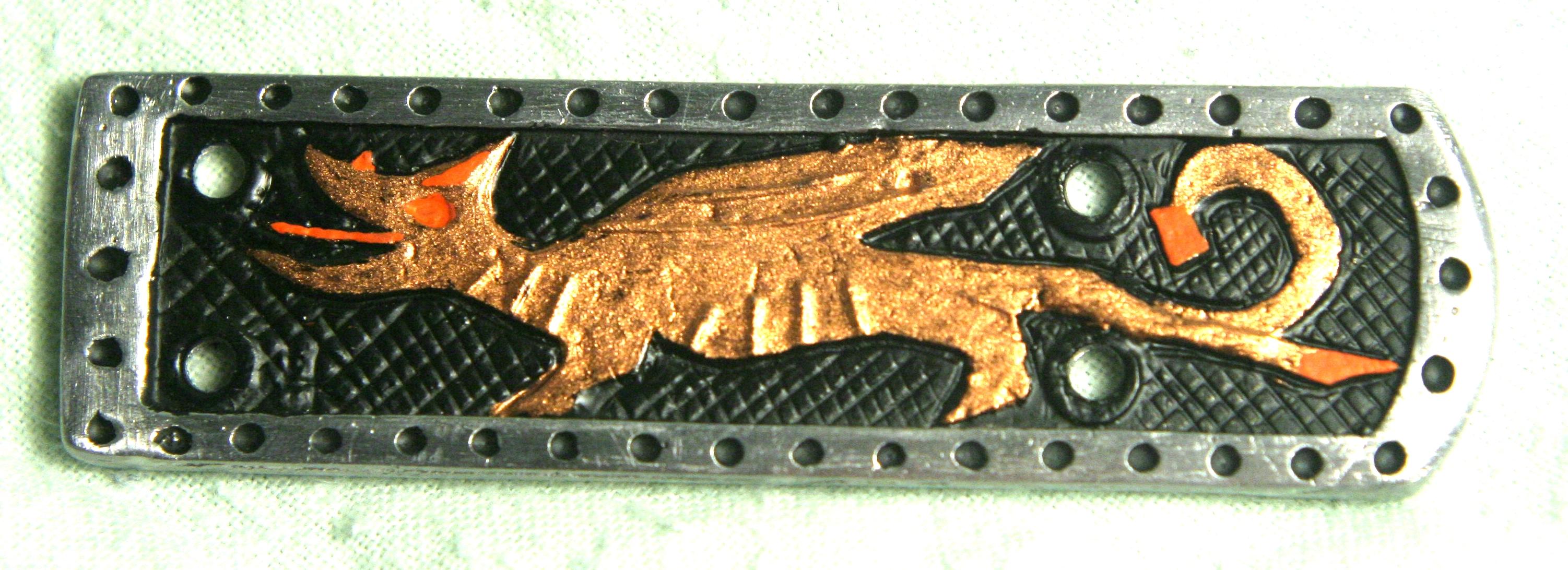

When tin and antimony is added to lead to make pewter it lowers the melting point temperature. For this mix I use a special heat proof silicone rubber to make the mould. The heat proof rubber is meant to be used with pewter casting Plaster is usually mainly used for a single one-off casting as the heat of the metal cracks the mould and it breaks apart when removing the casting This is a medieval style belt end I sand cast, then hand painted;

Just checked and the melting point of tin is considerably lower than lead so a silicone mold would be ideal for repeat castings. Won't work with silver though, temp is too high. I believe jewellers use plaster to make their molds but they would likely only be good for a couple of castings at most.
Good idea fred. kgg, yep, some use 3D printing to make their part and then use the "lost 3D" method to cast it.

I do some casting. I use 'model metal' which is a tin alloy and also pewter, which is a lead and tin alloy. For multiple castings I use a heat-proof silicon rubber mould and for one-offs. or two, I did the casting in oil sand For making conchos I'd use the rubber mould. Its good for about 100 to 150 castings. Less if you allow the metal to get too hot.

I follow your you-tube channel so watched it the other day and I was impressed at the fine detail you got, not easy with sand-casting. For tin-casting you might be able to get away with making the mold from silicon, it would allow for repeat casting and give very fine detail. As an aside after watching your episode about the Vevor press I just had to buy one - I don't really need it (yet) but it's a solid bit of engineering!! Keep the vids coming, they're always good to watch.
