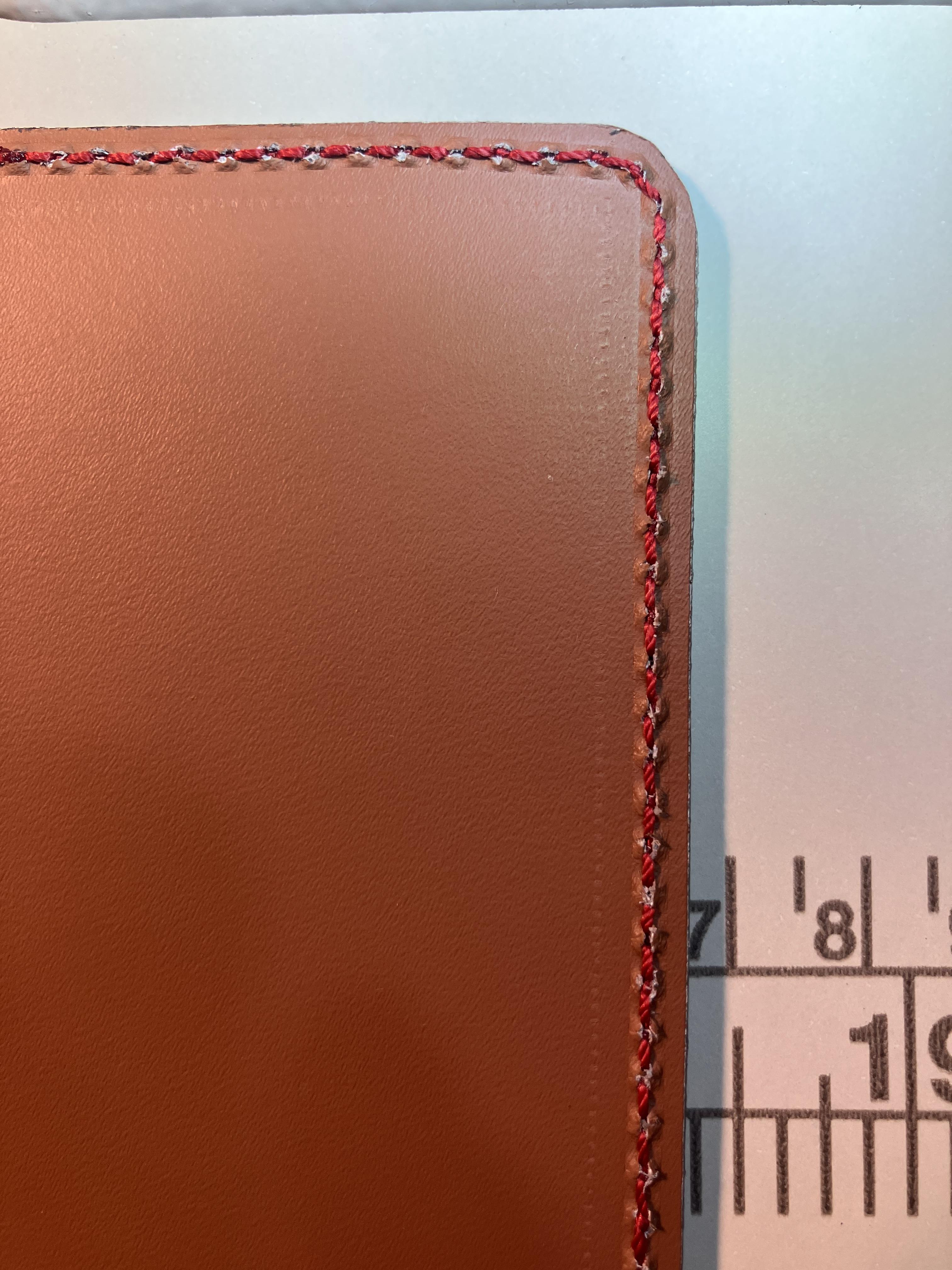

Try going over the stitches with a polished leather hammer. Or a polished bone folder.
