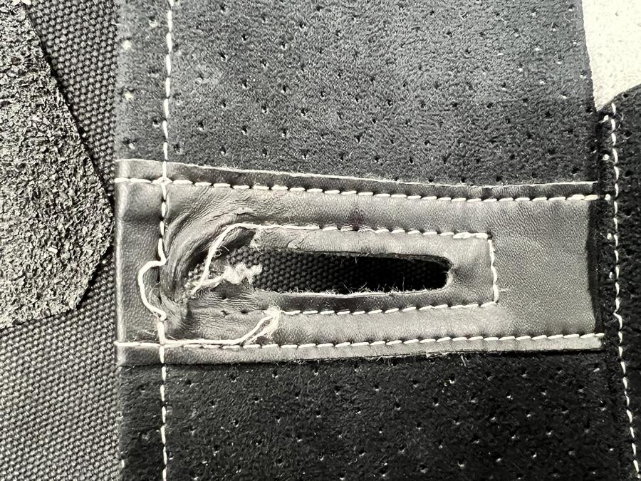

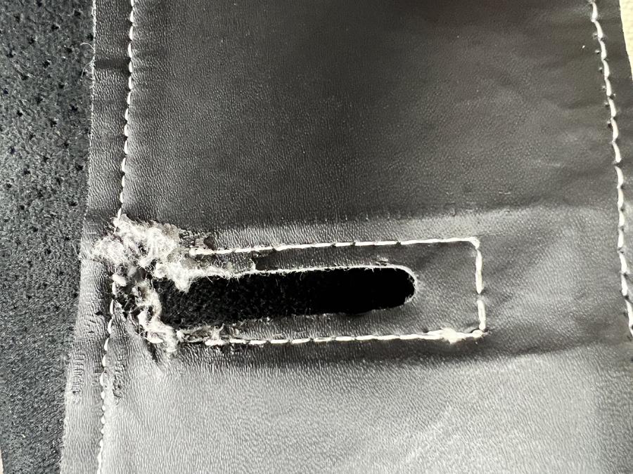

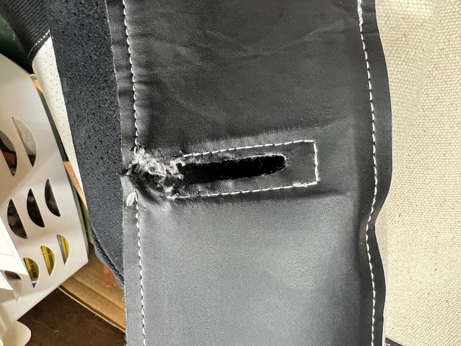

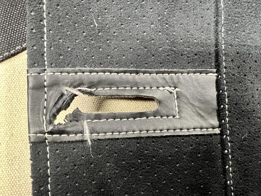

Repair of Shooting Jacket button holes
Leather Repair Center replied to PAMuzzle's topic in How Do I Do That?
Hey all, I’m in the leather repair niche — mostly work on furniture, auto, and commercial seating — so I don’t typically deal with jackets, but this caught my interest. I showed the photos and details of how I would fix it to my AI assistant and asked how we might repair this jacket, and it gave some solid advice that lines up exactly with how I’d approach it. Here’s what it suggested: AI’s Recommendation: 1. Remove the Damaged Panel: Carefully unstitch the torn synthetic leather piece, using it as a template. 2. Replace with Genuine Leather: Cut a replacement patch from 2–3 oz genuine leather (not too thick, but durable). This will hold up better than the original material which looks like thin vinyl or bonded leather. 3. Reinforce from the Back: Use a strong woven backing or thin nylon webbing glued behind the leather to add strength and prevent future tearing. 4. Recut and Reinforce Buttonholes: Recreate the slits and stitch around them tightly, or even use grommets if appropriate. If possible, roll the leather edges or saddle stitch for extra strength. 5. Stitch Panel Back in Place: Sew the new piece back over the original location, making sure it’s clean and matches the rest of the jacket. Optional: carry the leather around to the front as a decorative piece, which would both look good and reinforce the structure. I’m honestly impressed with the advice the AI gave — this is exactly how I would fix it myself. Hope it’s helpful -
What kind & brand of dye did you try to apply to it?
I would remove old ripped piece or not, then sew a piece of leather folded around the front & back, then use a oblong punch & punch a slot in it. Then I would sew around the oblong hole you punched thru it to reinforce it all.

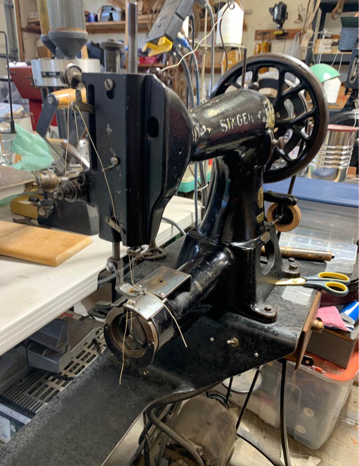

Singer 45k25 - is it worth $1200?
AlZilla replied to MackProvisions's topic in Leather Sewing Machines
Exactly, for a production machine that has to work when needed, that's the wrong choice. As a very cool old machine, it's exactly the right machine. I'd love to have it but I wouldn't be anywhere near $1200. Less than half that, to me. Others will differ. There just aren't that many people who collect large chunks of cast iron. -

Just replacing that reinforcement on the inside would let you restore the shape of the button hole. Maybe even carry it around to the front as a decorative element. Just ruminating, really. That repair is out of my meager skill set.
MackProvisions replied to MackProvisions's topic in Leather Sewing Machines
Thank you! I appreciate your help. -
The question you need to answer is what you want to sew. With such old machines certain parts can be difficult or impossible to get. The clutch motor presently on the machine should be replaced with a servo motor to get your sewing speed to a comfortable level which will cost about an additional $200. Learning to use a clutch motor can have a very steep learning curve, sort of like learning how to drive a car with a stick shift. Since your bio you mentioned wallets a flatbed machine would be a better choice then a cylinder arm. When you add in the cost of new servo motor cost would be about $1400. A new flatbed clone of the Juki DNU-1541S a Cowboy CB-1541S will cost $1600 plus shipping. Personally I would go with a new machine particularly if this is your first machine. kgg

There’s a Singer 45k25 for sale in my area. Old clutch motor attached to treadle. What does everyone think about $1200?
A friend of mine has a competition rifle shooting jacket and asked if I could fix the button holes that are torn. The leather surrounding the holes is very thin and sewn/glued to material backing. As you can see from the photos, the holes have been torn out of shape. I'd like to glue something to a new leather covering. I was thinking nylon webbing material to give it more strength? Any suggestions/advice? Thanks
