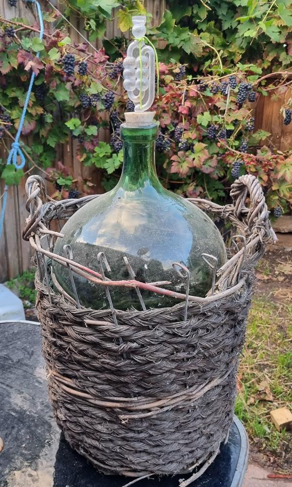

I acquired a large carboy and a few demi-johns as well as the rest of the paraphernalia needed for this journey. I now have three mash bins full of de-stemmed grapes and water and yeast that was put in two days ago and the must is almost at the top of the bins. I haven't adhered strictly to the recipe due to lack of equipment at the right time. I'm told online that I shouldn't have added water despite the recipe calling for it. Time will tell. This post is about the large carboy. I bought it from my new French friend who brought it from France years ago. To say the basket is very fragile is a huge understatement. I know I don't really need the basket but I'd like to know you guys thoughts on how easy it would be to restore it. I will make a leather bottom and lace it to something around the top but I will oil it and look for some wicker? I think it's worth saving. Your thoughts guys?
