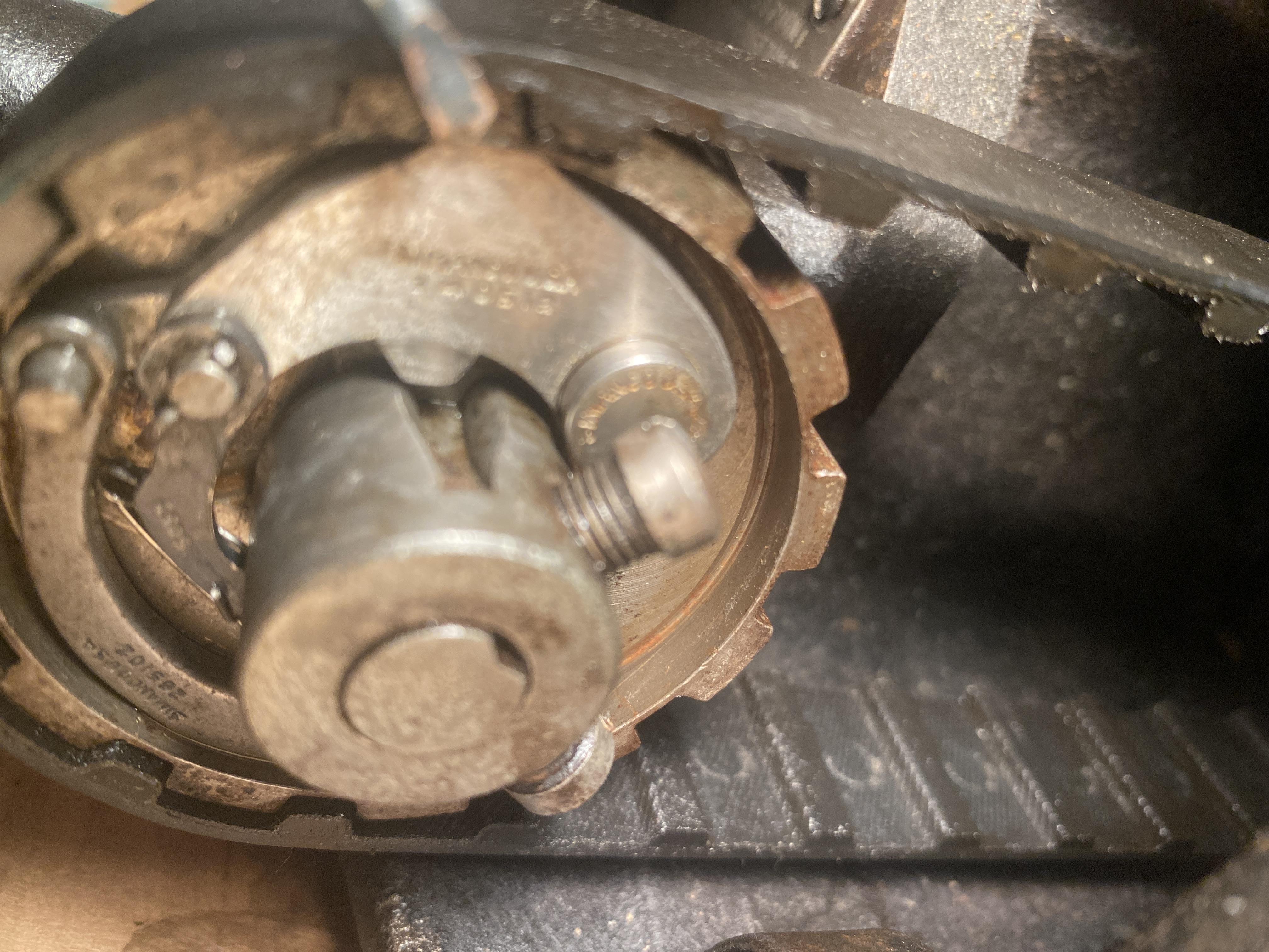

  2. Thank you KGG I will try that.
  3. Personally I would remove the cotter pin on the catch arm pivot point, the catch arm that catches the side of shaft and see what going on. Maybe the hole in the larger piece at that point has worn the pin or the hole in the larger piece has been enlarged. What do you have to lose? kgg
  4. Thanks, Bob for all your help I did engage the shaft, but unfortunately, it did not move or change the position of the piece of metal that’s supposed to go into the slot see picture above even after moving the wheel towards me and or away from me

  6. Like I said b4,push the button & while holding it down push the handwheel backwards & it'll snap back in.
  7. Photo 2 I believe that there should be a space between the outer wall and the plate but correct me if I am wrong. It seems stuck up there.
  8. Photo 1 …..pointing to slot….its not lining up.
  9. We pushed button. It is in gear. Shaft is moving perfectly but we still have the problem in the video. The little piece ( don’t know what it is called) is not going into the slot the way it is suppose to. It is just on the edge of it.
  10. Thank you cowboy Bob and kgg. We did engage the button. That was the first thing the repair guy did. Fixed the button and engaged it. Then he went to clutch area and that is when everything stopped. He fixed and tweaked everything else but did not feel comfortable taking apart clutch. We have been oiling for two days. Here is where we are at. Thank you for any help.

  12. Hi Bob This is Ron Nancy’s husband. Thank you for replying. I did watch the same video Singer Safety Clutch above several times. Here is the problem I’m still having. Any help will keep me out of the dog house 😂

  14. Moved your post to Dyes, Antiques, Stains, Glues, Waxes, Finishes and Conditioners Check through this forum. Mainly, you will find that you need to buff the purse with a clean white soft cloth until it stops transferring dye (rub off) to the white cloth. Then it needs to be sealed with a finish product that could be a lacquer and water based sealer. You find various names as you peruse this forum.
