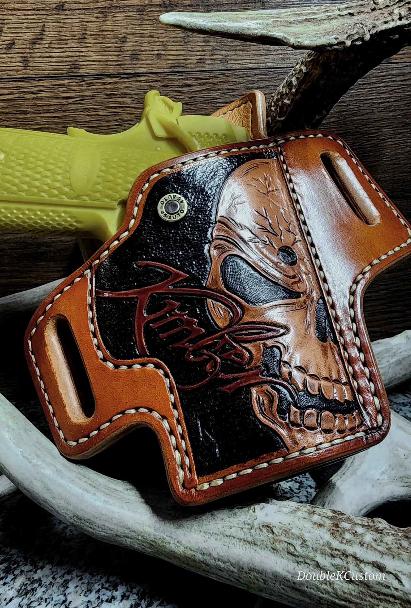

Just as an addition here. They do make a 45 acp rivet like the shotgun shell. I know it's got the 270 winchester rivets on Amazon, but i think the 45 acp was from weaver or tandy. You'll see it on this holster.
