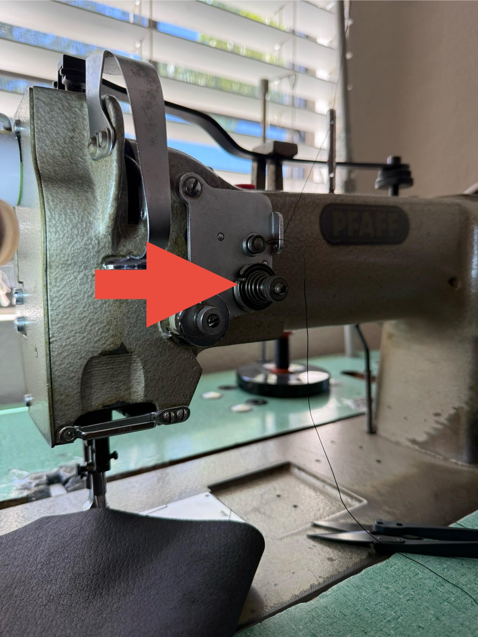

As far as it's backed off I really doubt the tension is the problem,my guess is look for it to be binding ( or getting caught) somewhere between the spool & machine.

I'd take the tensioner apart and see if there's a burr or something else going on. Funny it would rear it's head right at a bobbin change, but it's worth a look. Another thought, make sure it's tight starting at the tensioner and not further along the thread path. Be sure where the problem starts.

I have a Pfaff 145 H3. I ran out of thread while sewing and had to refill a bobbin. After rethreading my machine, everytime I sew after a few stitches my top thread gets stuck in my tension disc (The top thread becomes extremely tight - to the point where pulling on it makes it snap - and the stitches start to show the bottom thread on top). I then have to rethread the top thread, then after a few more clean stitches, the top thread becomes tight and the issue persists. Ive attached a photo here of the tension disc. Nothing has been done to it or changed. I am not sure why this keeps happening now. Any advice?

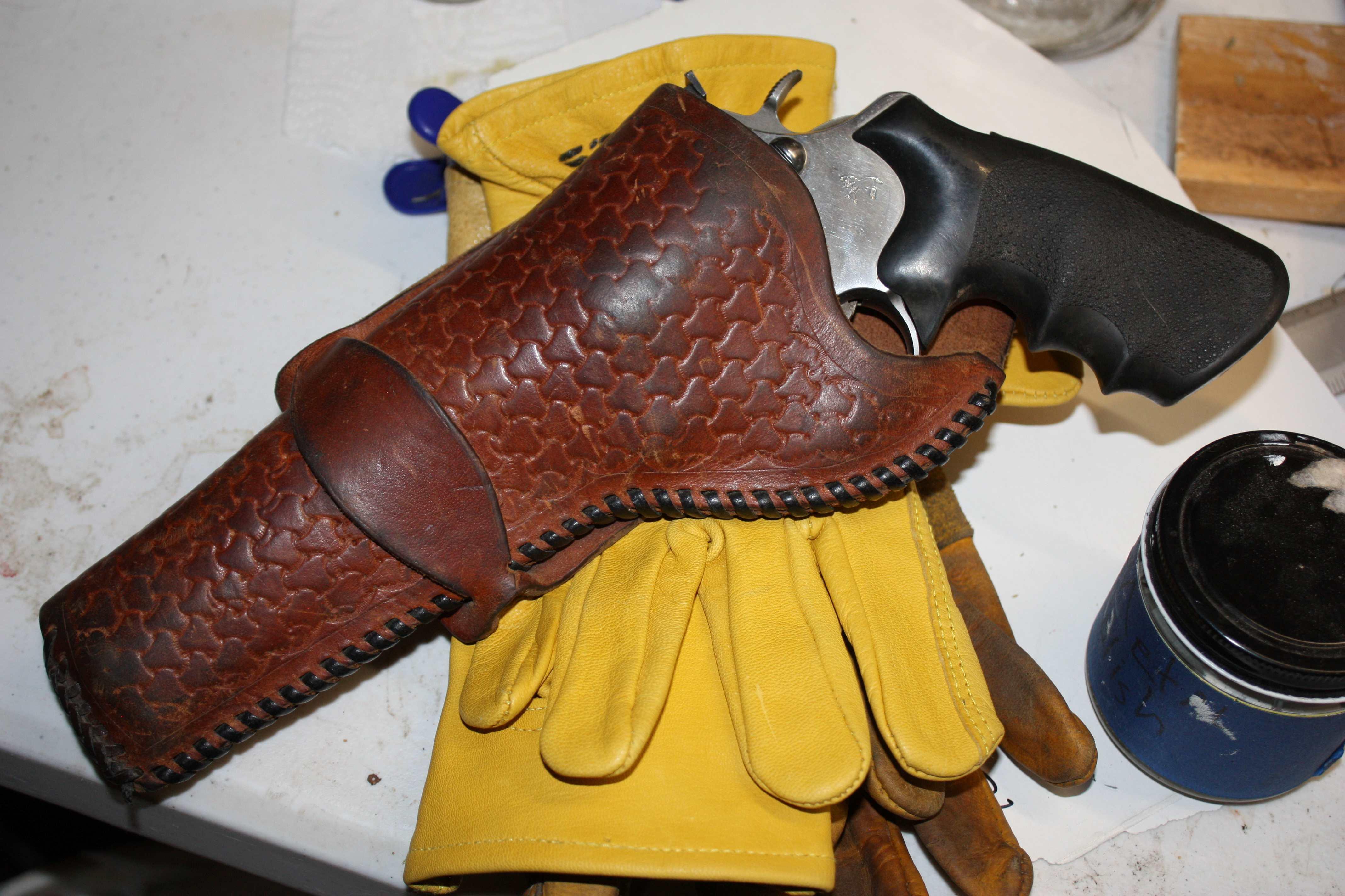

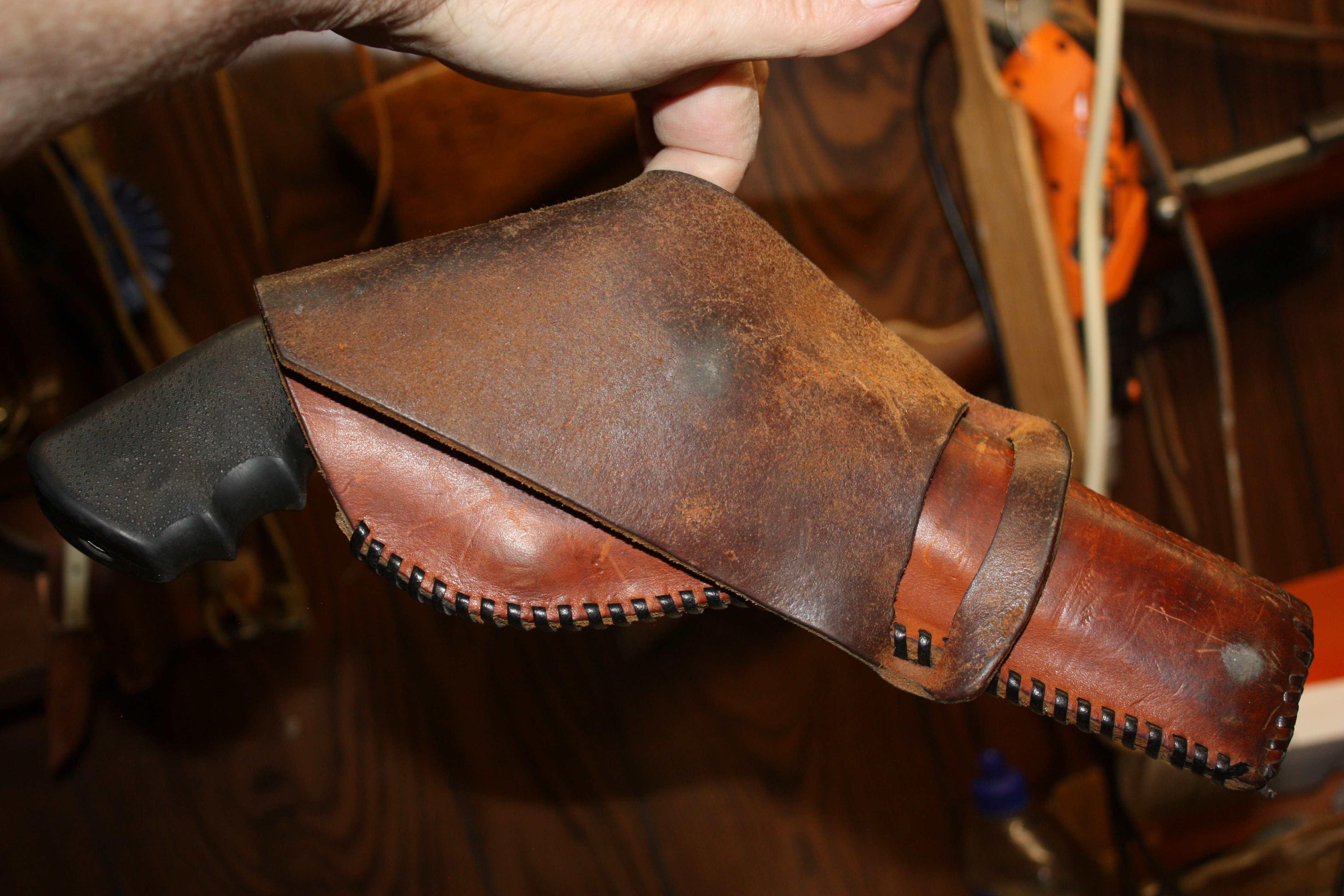

Here are a couple of pics of my crossdraw, as you can see it's had some use lol. But its prime use is to keep my original Colt Anaconda looking good, clean, and functional in extreme circumstances. It's made deep to cover the cylinder, closed to protect the barrel, and you can see that the loop is made so the gun hangs at an angle, with balance being the key factor. you don't want your loop fighting gravity.
