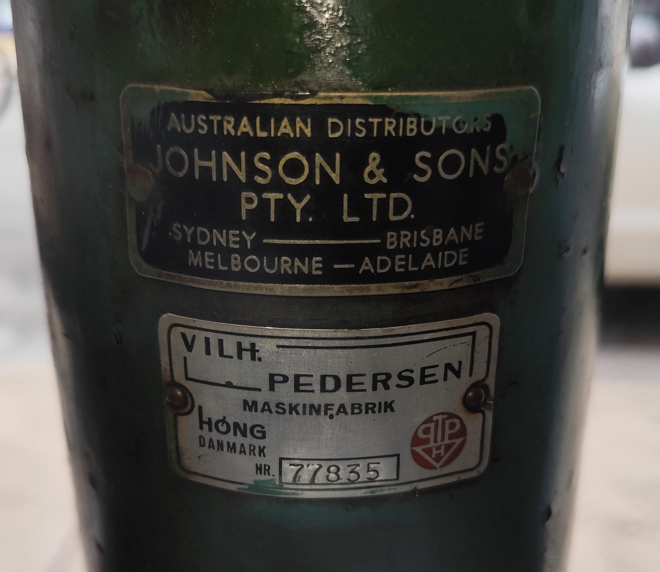

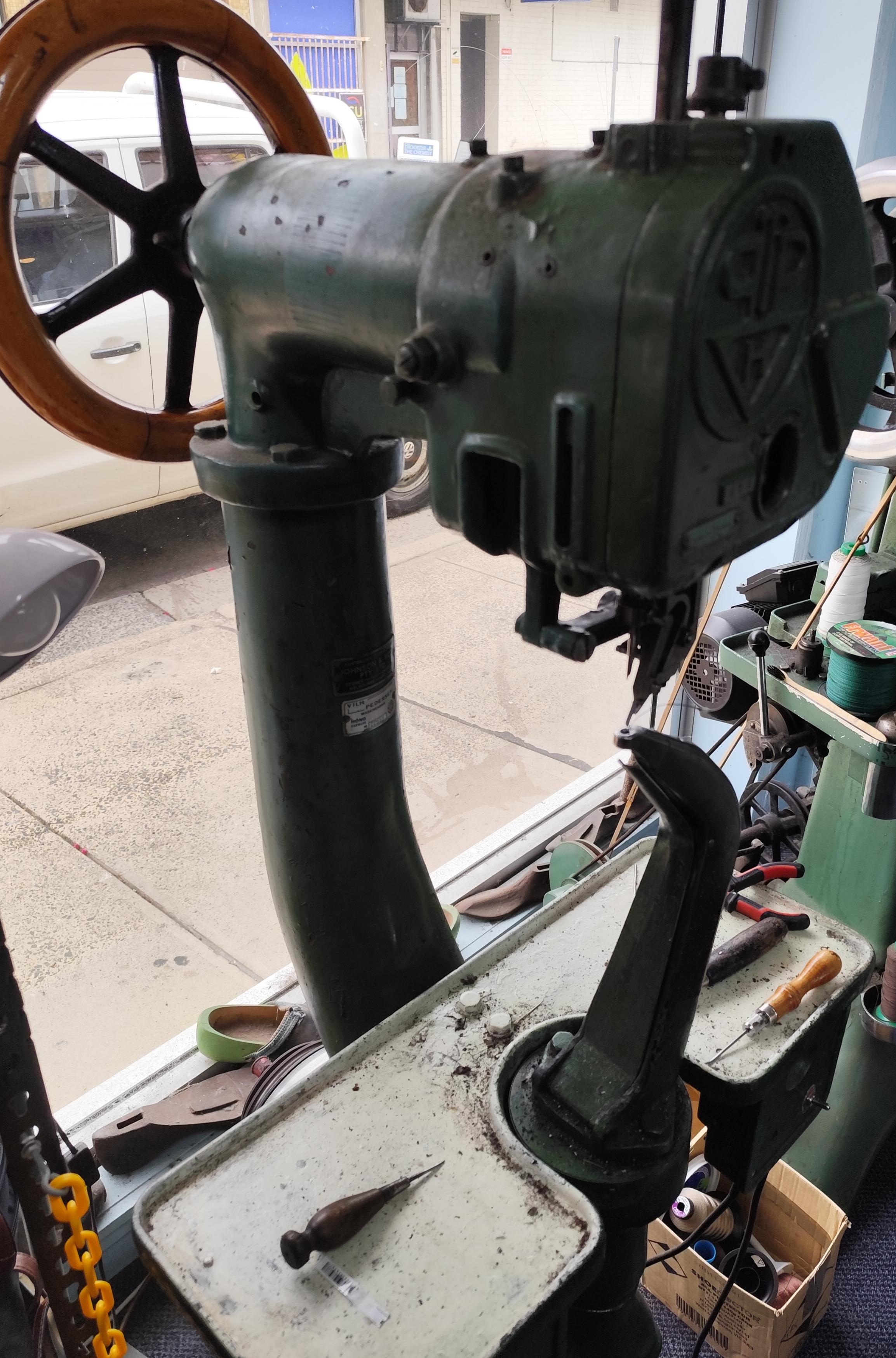

We have a Vilh Pedersen chain insole stitcher. We use it as bought 3 or 4 years ago. I would love to know if I can change the stitch length from about 6mm to 12 to 15mm. I would also love an operating manual if they exit. Thanks Matthew
