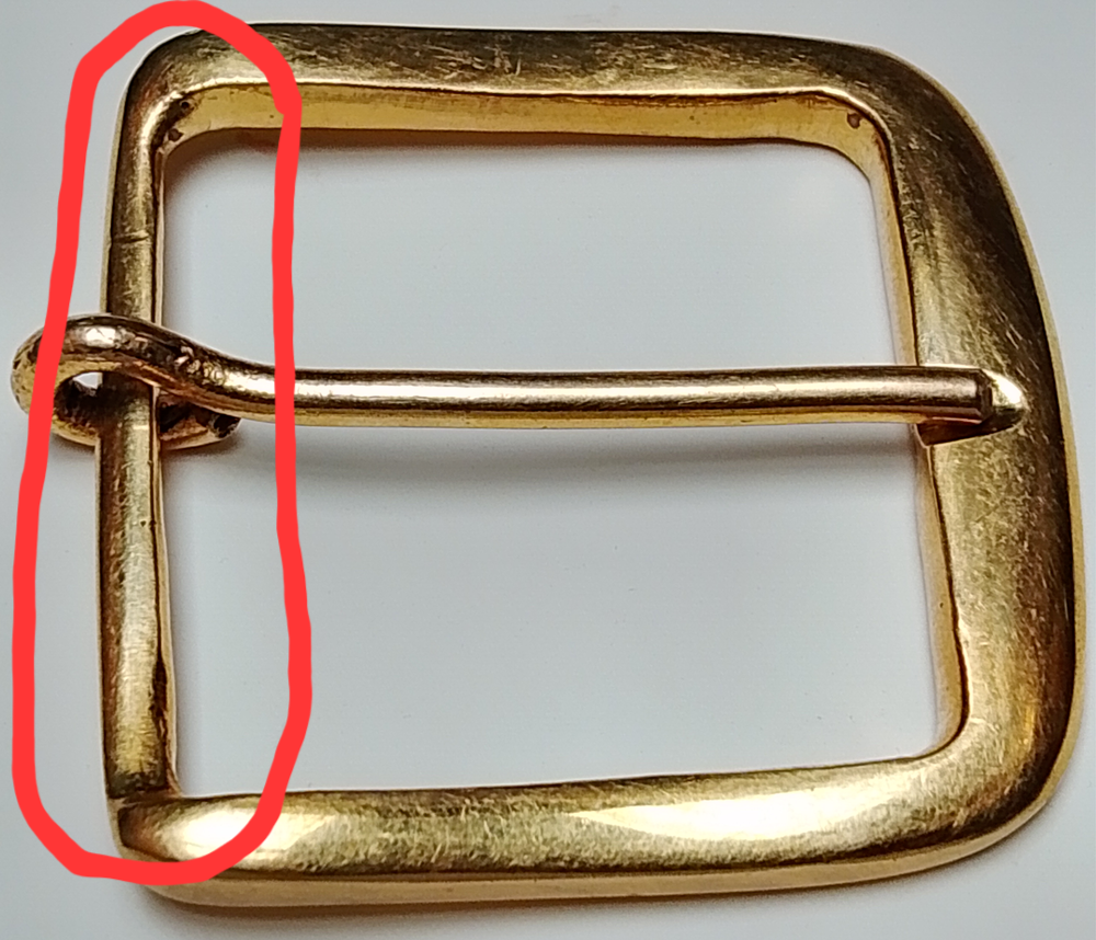

Hi John G Welcome to the forum. To me the most important points are: Strength/solidity Size Design/style Finish to me is part of the style, and I normally prefer just a regular brass finish like the one in your picture, alternatively it could be silver coloured, but I prefer no "bling" on my buckles. Prize is not especially important since I don't make 1000 belts, and compared to the time invested in making a nice belt, the prize for a buckle is only of secondary importance. But I guess that if you run a regular production of belts, it is of more importance. I like the small "dip" wehre the prong of the buckle nests. That is a nice touch in my opinion. Depending on what type of product I am making, I use either "normal buckles" like the one in your picture, or "roller buckles" or "center bar buckles" For belts I prefer sizes 1.25" and 1.5" (30mm and 38-40mm). Brgds Jonas -
Hi everyone, My name is John, I’m writing from Nairobi, Kenya. I’ve been fascinated with leatherwork and metal casting for a while, and recently started experimenting with sand-casting solid brass buckles and hardware in a small foundry and workshop. I’m still at the beginning of this journey, but my goal is to create strong, character-filled pieces that makers can use in belts and straps. Along the way, I’m also hoping to learn more about what leatherworkers actually look for in their hardware — things like finishes, dimensions, or styles that make your work easier. Outside of casting, I enjoy exploring traditional crafts and finding ways to combine them. I came across leatherworker and I’m looking forward to being part of the community, learning from you all, and (hopefully) contributing something useful as I go. Thanks for having me! — John M. near Nairobi, Kenya
Hi everyone, I’m new here and just getting started with a small project I’ve been working on for some time: hand-cast solid brass buckles and hardware. I run a small foundry and workshop near Nairobi, Kenya, where I make each buckle in small batches using traditional sand casting. Right now I’m at the stage of introducing these pieces and learning what makers actually look for in their hardware. Strength and authenticity are my focus, but I’d love to hear what you value most — sizing, finish, style, or price point. Here’s a look at what I’ve made so far: https://origibelts.com/collections/wholesale Any thoughts or feedback would be really appreciated as I start this journey. Thanks for letting me be part of the community. Sincerely, John G. Origibelts – Nairobi, Kenya
