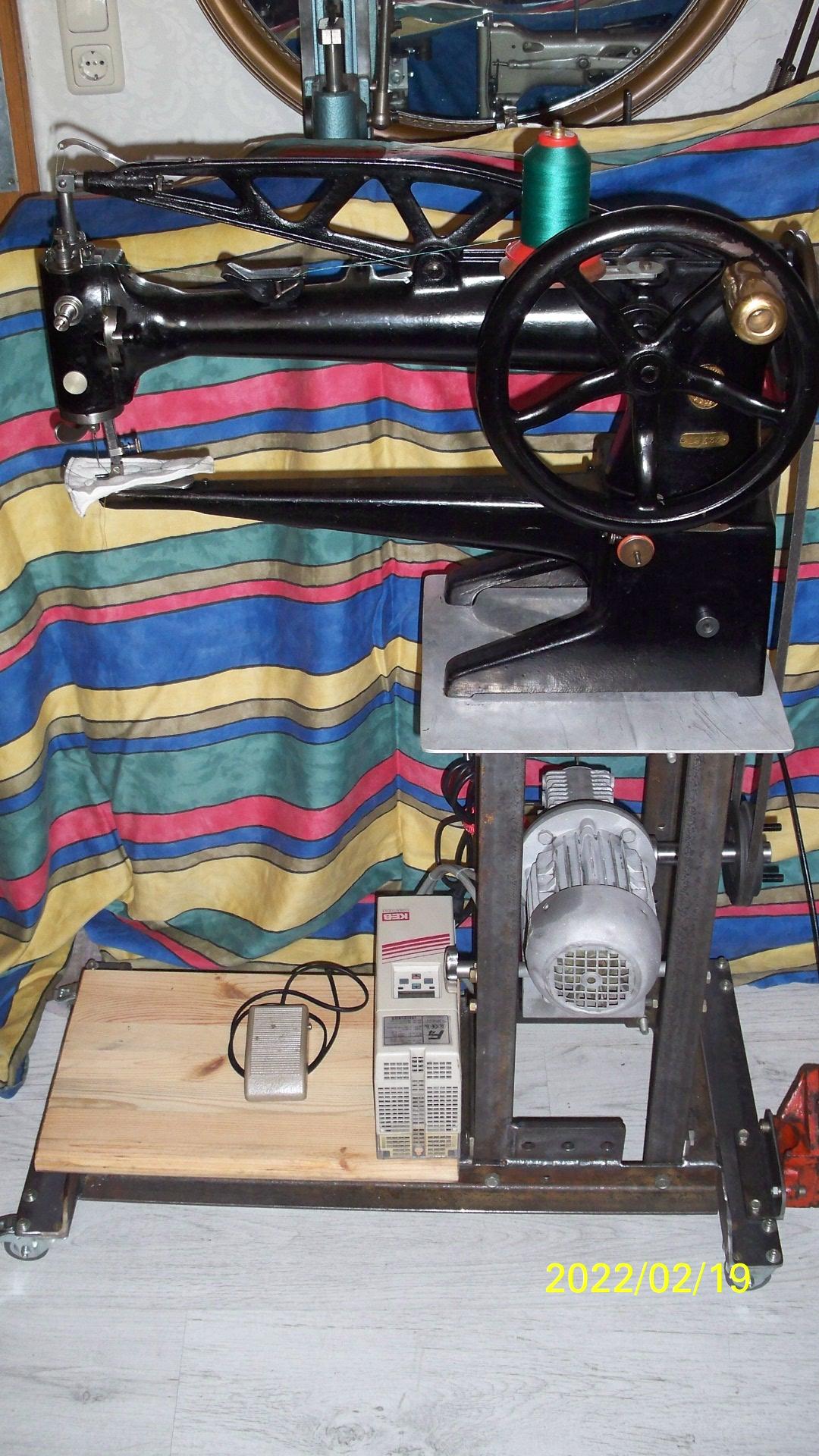

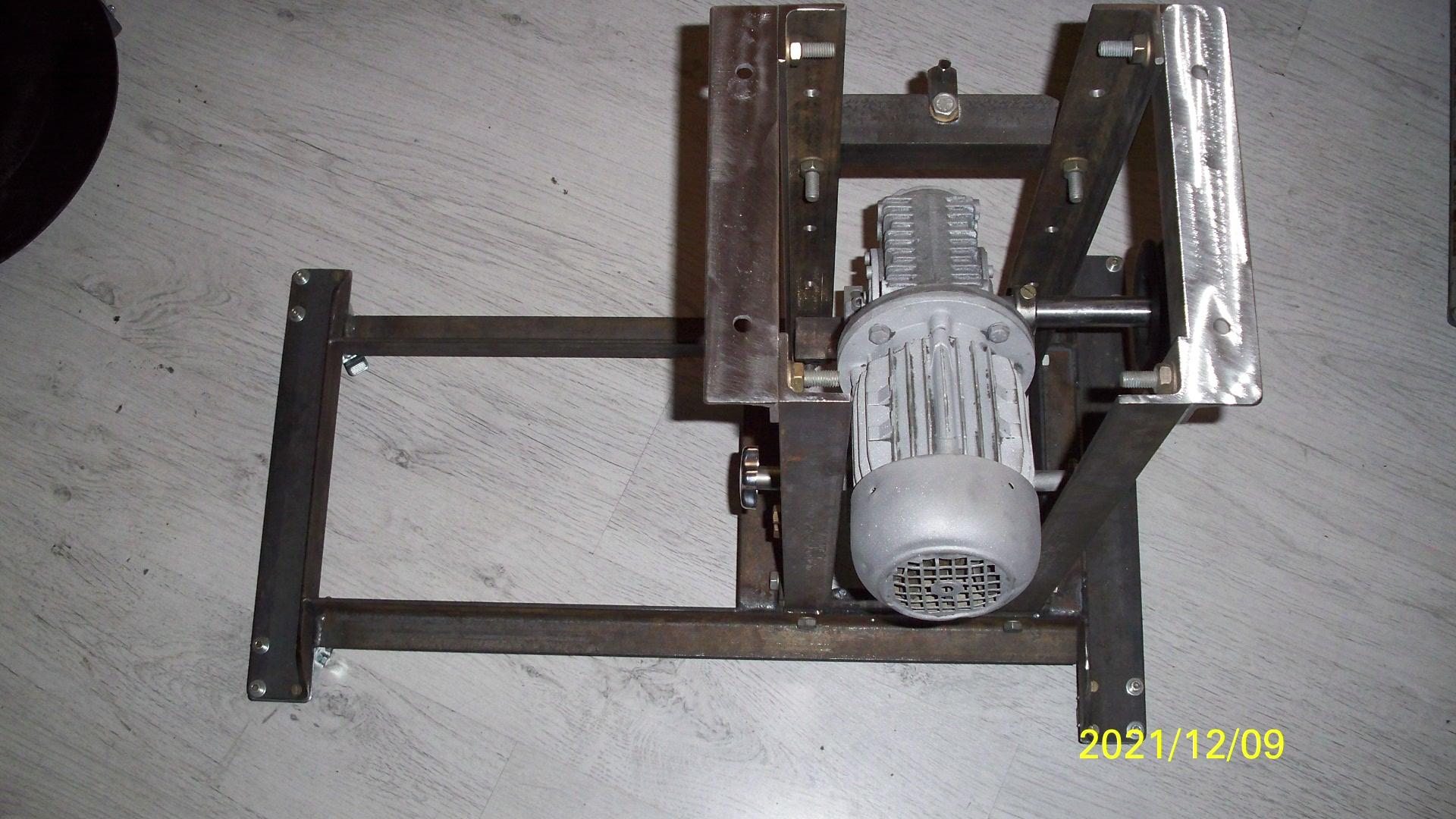

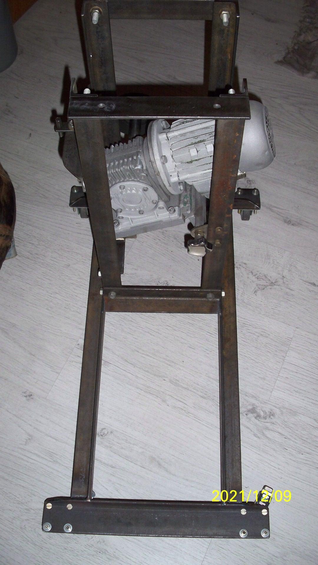

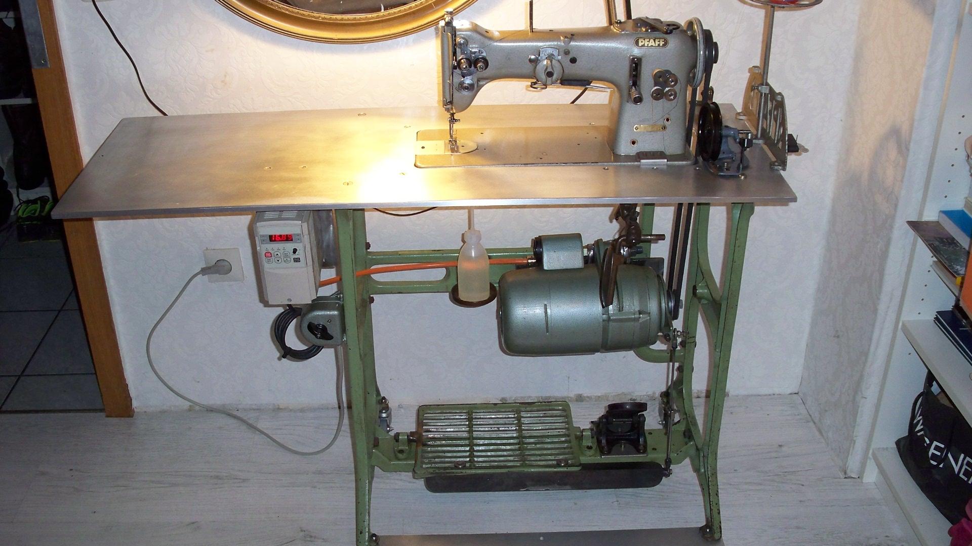

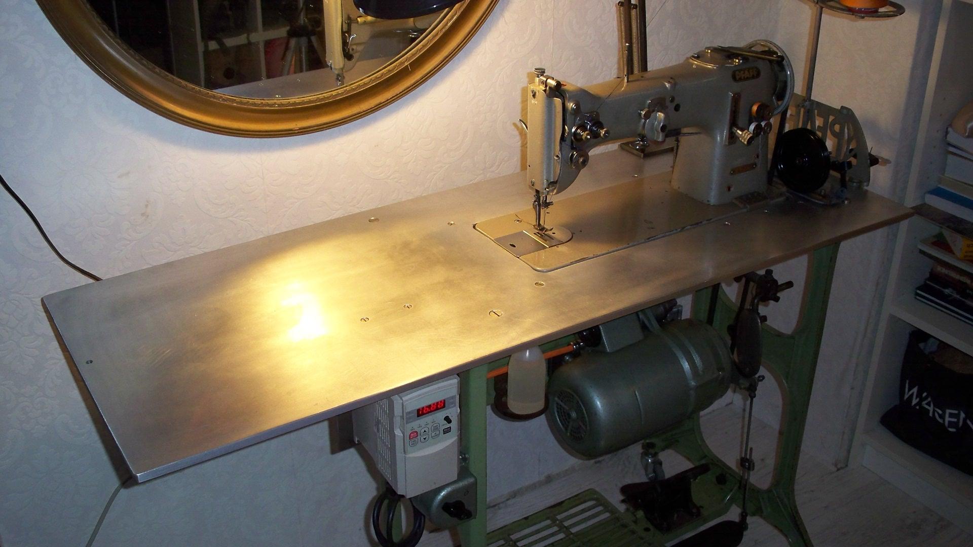

Hi, Being a metal worker by trade, I made my table top from a sheet of 12mm (about 1/2 inch ) aluminum plate for my Pfaff 138 For my Singer 29-33 (now replaced by an Adler 30-7 cause it handles bigger bobbins) I made the whole table from angle iron - bolted together to show other people that it can be done without any welding skills - even though I´ve been TIG welding for nigh on 40 years. Greetings Hans
