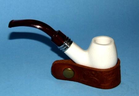

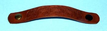

  2. Here's a wee item youse can whip up from a bit of scrap. Got an odd piece from cutting a belt to length? A portable pipe rest for pipe smokers. Sell it at fairs, stalls or where ever, or even give them away with your brand stamped on it This one is about 19cm long x 3cm high and 2.5mm thick - cos that was wot I had. One snap, and one cover piece. Stamped and dyed Keep to using a snap or such to keep the pipe rest thin so it can be carried in a pocket or baccy pouch. I tried a Sam Brown stud but that sticks out too much 19cm long + or - 1cm is about the right length. 3cm high is about right too
