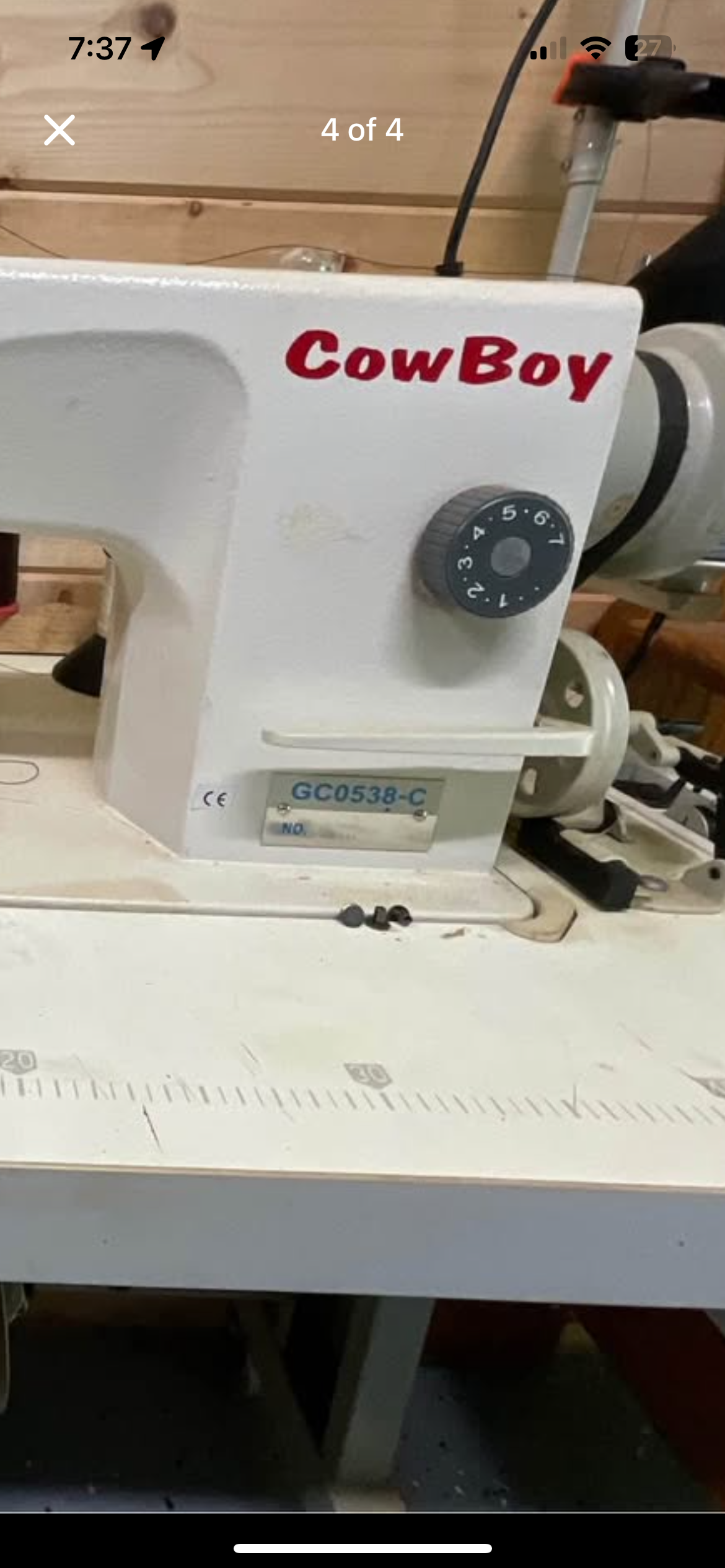

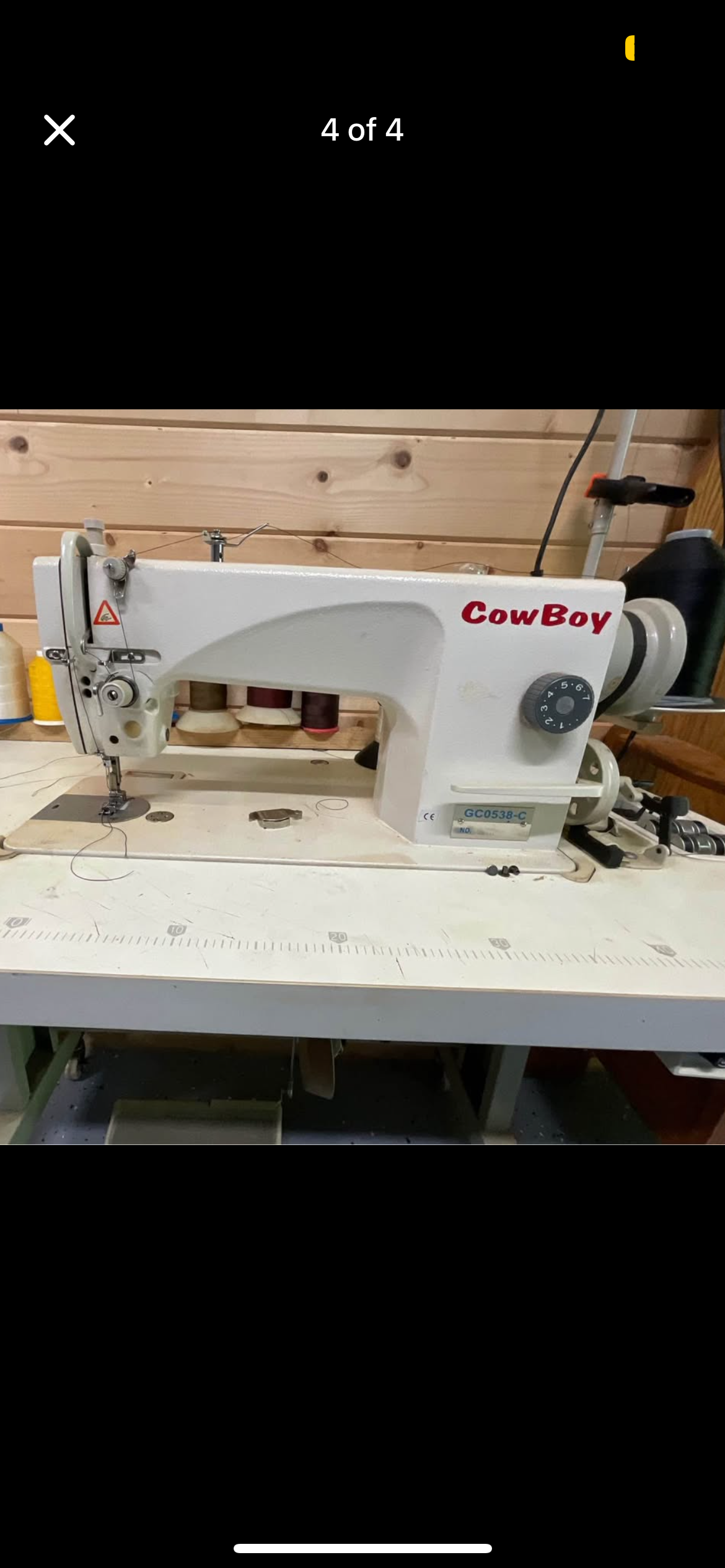

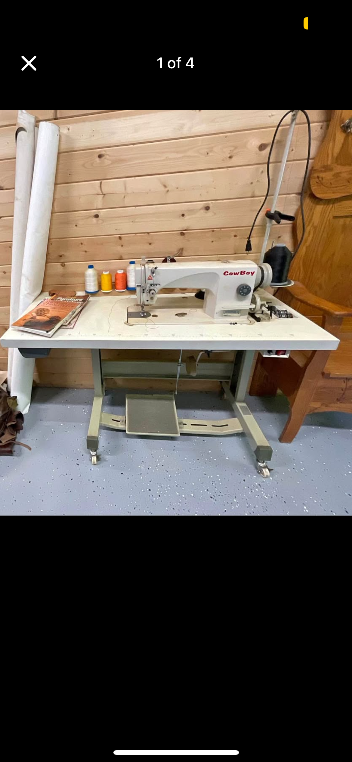

This machine from what I understand is: i) A drop feed needle feed machine. Not what I would attempt to use for holsters as you really need a compound sewing machine (feed dog, presser foot and needle) for leather work. ii) I would consider this more geared towards fabric then leather. iii) As far as sewing 1/2" I think this is very doubtful, at best maybe 3/8". iv) The thread limit I would suspect would be V92 maybe V138. How thick is the leather you are planning on sewing? What size of thread are you wanting to use? Are you sewing presently by hand or by machine??? The first I have ever heard of the shank size determining the sewing thickness. kgg
I can't tell exactly what machine that is but it doesn't look like any kind of a walking foot machine. A walking foot is where you're going to want to be for holsters. Also, a half inch lift doesn't mean it'll sew a half inch. It needs a little room to work. While we wait for one of the experts to chime in on that machine, here's a thread you should read through: https://leatherworker.net/forum/topic/25239-the-type-of-sewing-machine-you-need-to-sew-leather/ And then look here and go over machines from the CB3500 down to the Outlaw. These are sort of the holy grail range for heavy leather like holsters and up: https://www.tolindsewmach.com/cowboy.html Plenty of other machines will work and there are always used machines to get the cost down a little. And, who knows, maybe the machine you asked about will be some kind of walking foot. The 1/2" lift doesn't give much room for growth, but maybe. Enjoy the chase for your machine.

I am looking for information on the capabilities of this cowboy sewing machine. It’s for sale locally to me for $850. The seller has this to say about it “This sewing machine is used for leatherwork. It has a 1/2” shank so it can sew through 1/2” thick leather. There are several manuals and spools of thread that come with it as well as a bag of scrap leather materials” is this an accurate representation of the machine? I see pancake holsters, belts and wallets right now. Will this machine work?

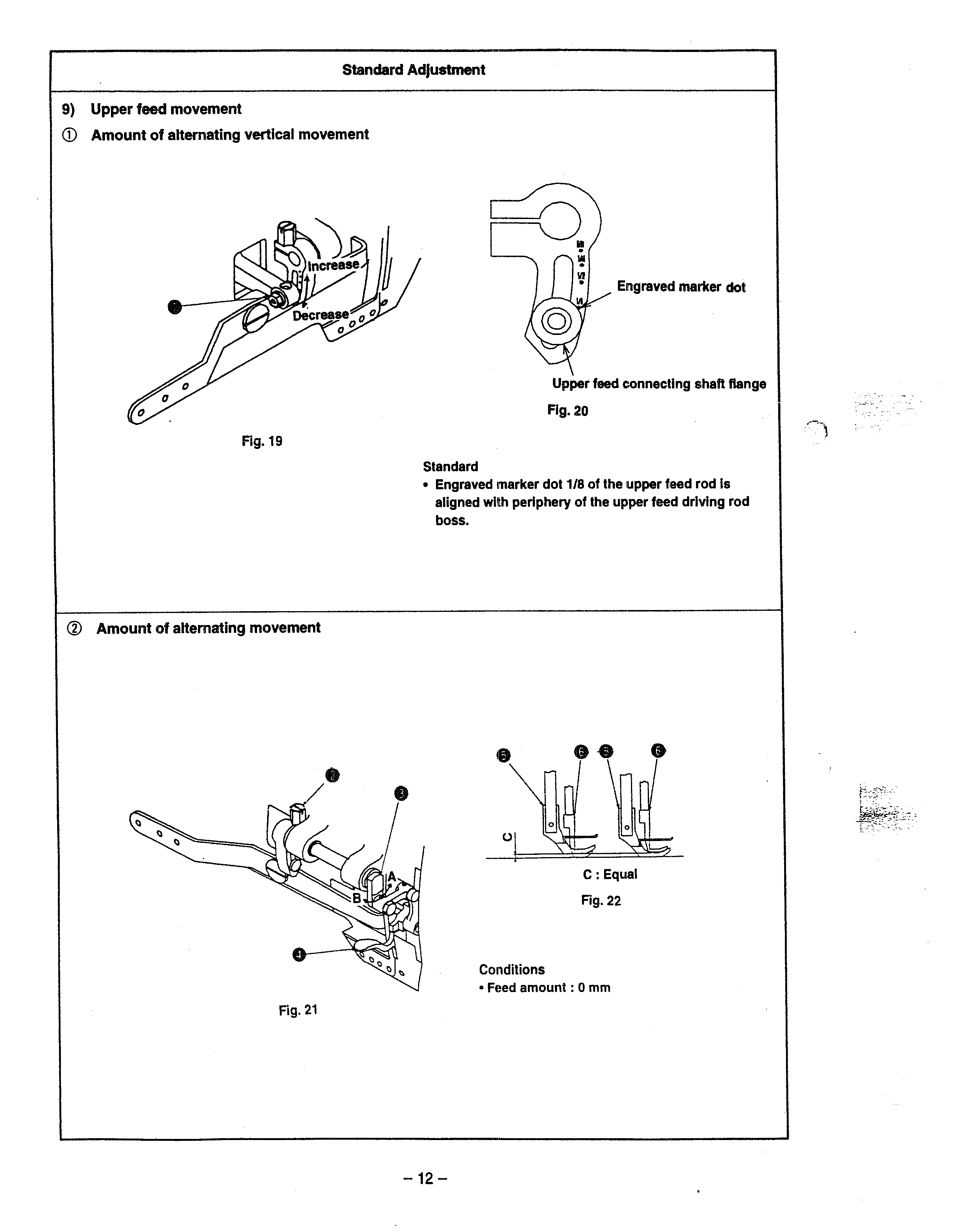

Thanks for replying. Sorry I should have given more background. The engineer's manual for the Juki 341N (attaching photo of page 12) shows two separate adjustments: 1. Overall lift height 2. Balancing the lift between the two pressers The manual does not explicitly say If you adjust #1 then you will afterward need to adjust #2, otherwise your feed timing will be off and your lift heights will be unbalanced. But I wonder if maybe that is what is required... The first few times that I adjusted the overall height (1) based on the manual I was baffled that lift height was unbalanced afterwards, or that feed timing was off afterwards. Eventually I tried doing (1) then (2) in succession, and that seemed to give a good effect. But it also got me wondering if it's typical to require (1) then (2) in succession, or if there's something else out of adjustment just on my machine that makes it require this two-part adjustment.

Sorry, early morning Nicotine level was low. Hadn't had my second cup of coffee and enough vaping. Use to be second cup of coffee and six smokes. kgg 341 engineer manual.pdf

Here is a copy of the Juki LS-431 engineering manual refer to section 9 page 12. kgg

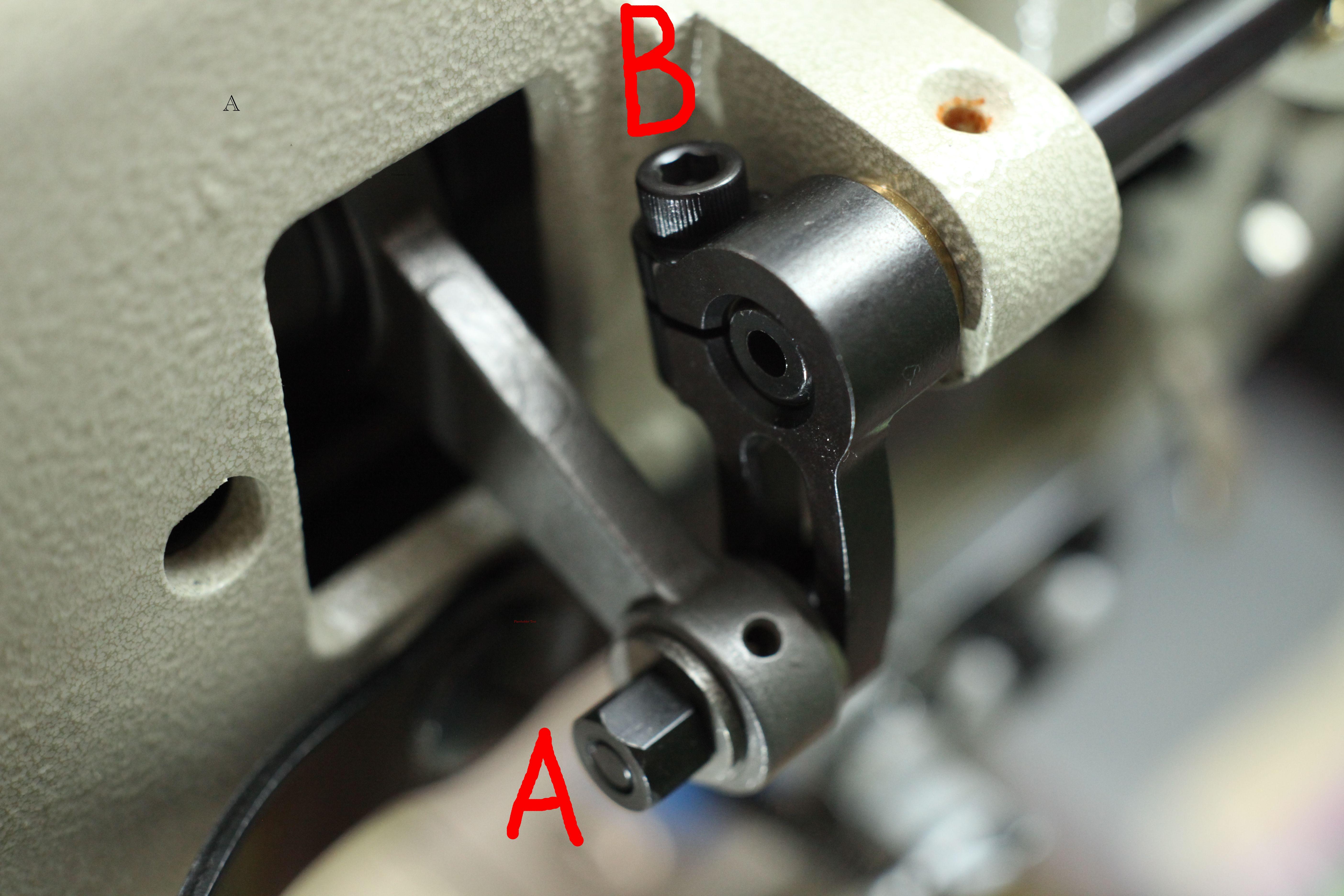

friquant started following Juki 341 Lift Height Adjustment
When I adjust the overall lift height using the banana slide (A), do I also need to set the needle point flush with the throat plate and then momentarily loosen the bolt (B) in order to restore equal lift between the walking foot vs the presser foot? Somehow I assumed the banana slide (A) was all that was required to increase/decrease overall lift, but if I only adjust at the banana slide then afterward one foot lifts much higher than the other. This is on a clone of a Juki 341.

Well, I've been hoping one of the experts would weigh in here, but I'll take a shot at it. On my Singer 29-3, there's a similar setup that controls how high the foot lifts. I'm thinking it's the same on your machine, but I'm pretty sure yours is a different brand. I have to go resize a picture. I'll come back and upload it.
