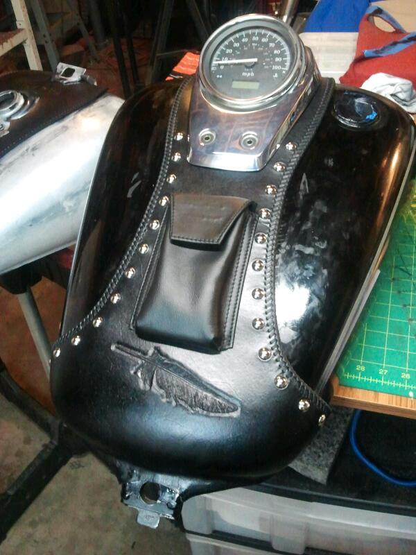

This was by far my most challenging tank bib to date. Client asked me awhile back about doing a picture of St. Michael he found on the internet. We got the details pinned down and the job scheduled but later when I was looking at the picture he sent me - a semi-basic computerized & altered rendition of the original painting - I realized I had seen it before way back when in Art History classes. I did some research and found the correct, original version and upon discussing it, he agreed to use the original as the basis. The is artwork was done in 1635 by Guido Reni and is titled, "Saint Michael Vanquishing Satan" or "Michael the Archangel Vanquishing Satan" depending on who you ask. Here is my rendition of it in leather, made for a 2003 Honda VTX1800C. Hermann Oak 5/6 oz A grade from Goliger Leather & triple loop edge lacing in black kangaroo. Golden Fluid Acrylics were used for the colors. I included some progress pictures this time to give folks a sense of what happens during the process. Enjoy! Chris Starting with a pic of the bare gas tank:
