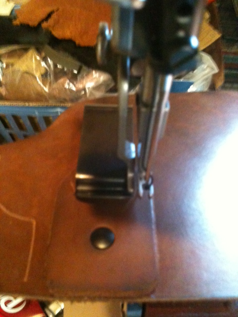

  12. This is EXACTLY what I needed to see. The presser foot is the key... the ones I have either fit to right or left, which is why I don't have the room I need. What kind of foot is that... and does anyone know where I can find one for a Cobra Class 4 ??? Thanks!

  14. Maybe I'm missing something here... but what is the best way to sew a metal clip onto a holster using a sewing machine? The left presser foot doesn't allow room to sew close enough to the clip. The right presser foot just falls off of the leather that I'm sewing...so the needle doesn't move forward. Is there a certain attachment that I should be using... or different method?? This should probably be in the "Sewing Leather" forum, but I guess it still involves a holster Hopefully this makes sense. See the pics for illustration.
