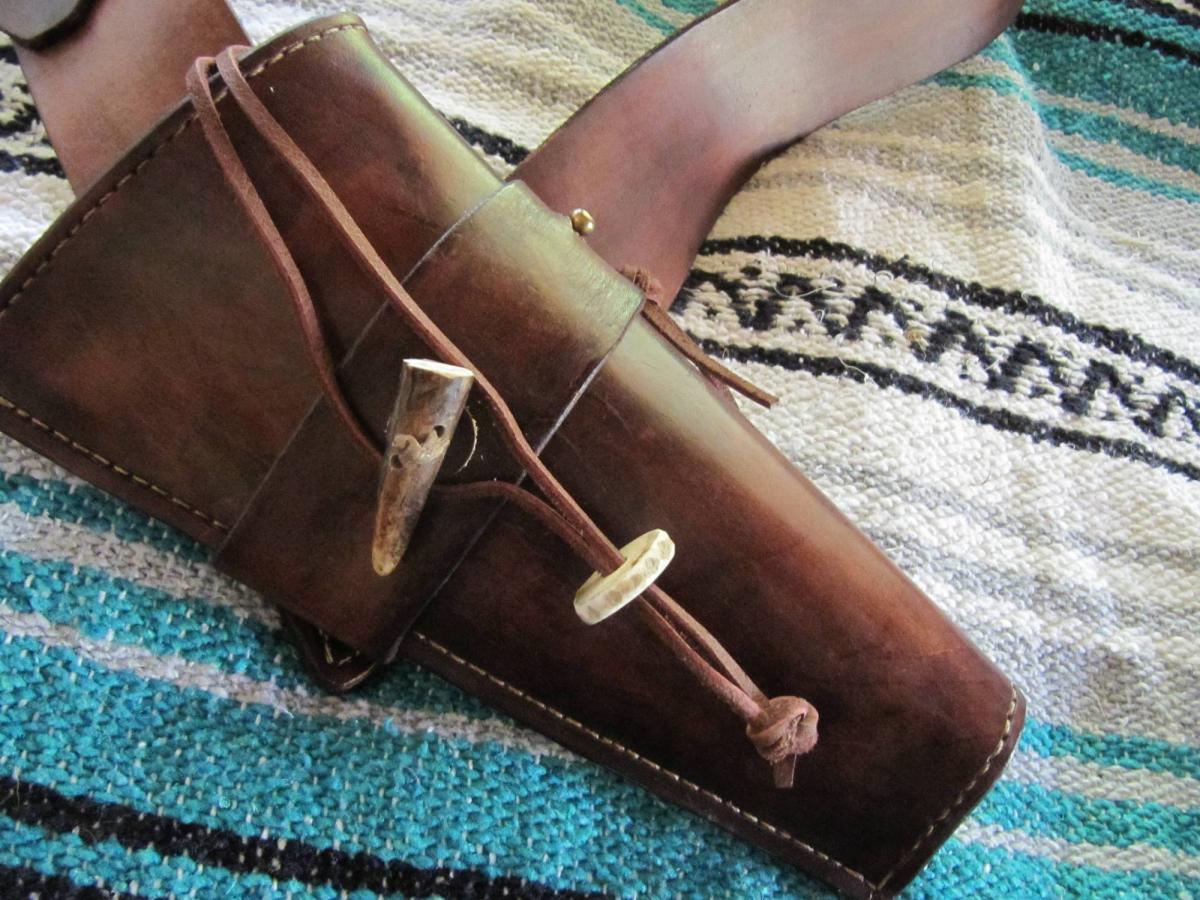

Don't know exactly what you are looking for here are a couple of ideas. The third picture a customer wnated a bandolier or baldric type shoulder belt andholster for a flintlock that would have the look of late 1700s early 1800s. He wanted a retention strap but did not want snaps. I came up with a antlet tine and sliding antler button.
