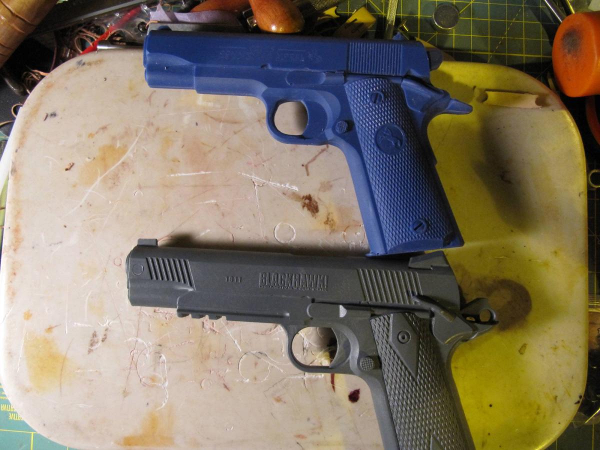

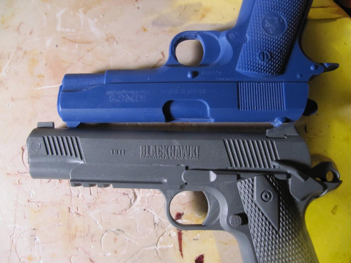

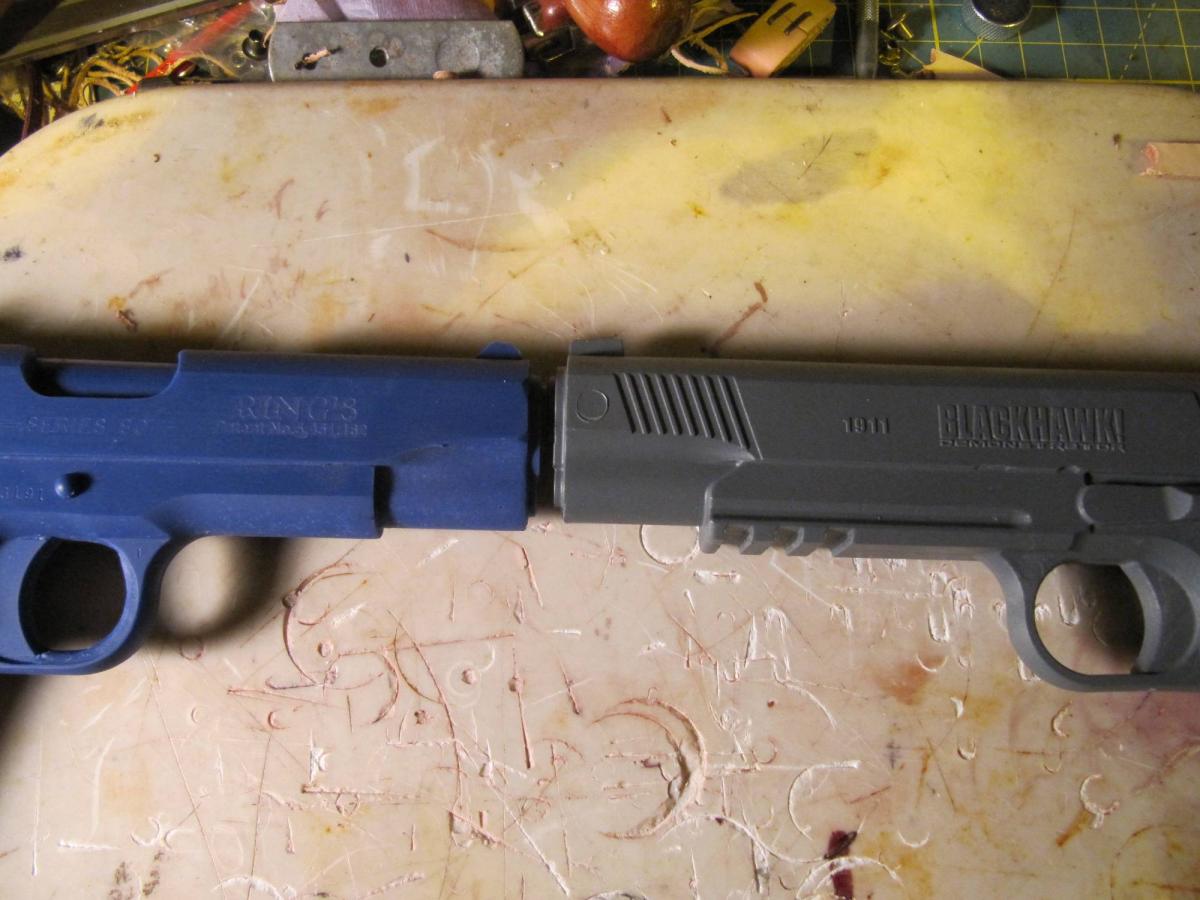

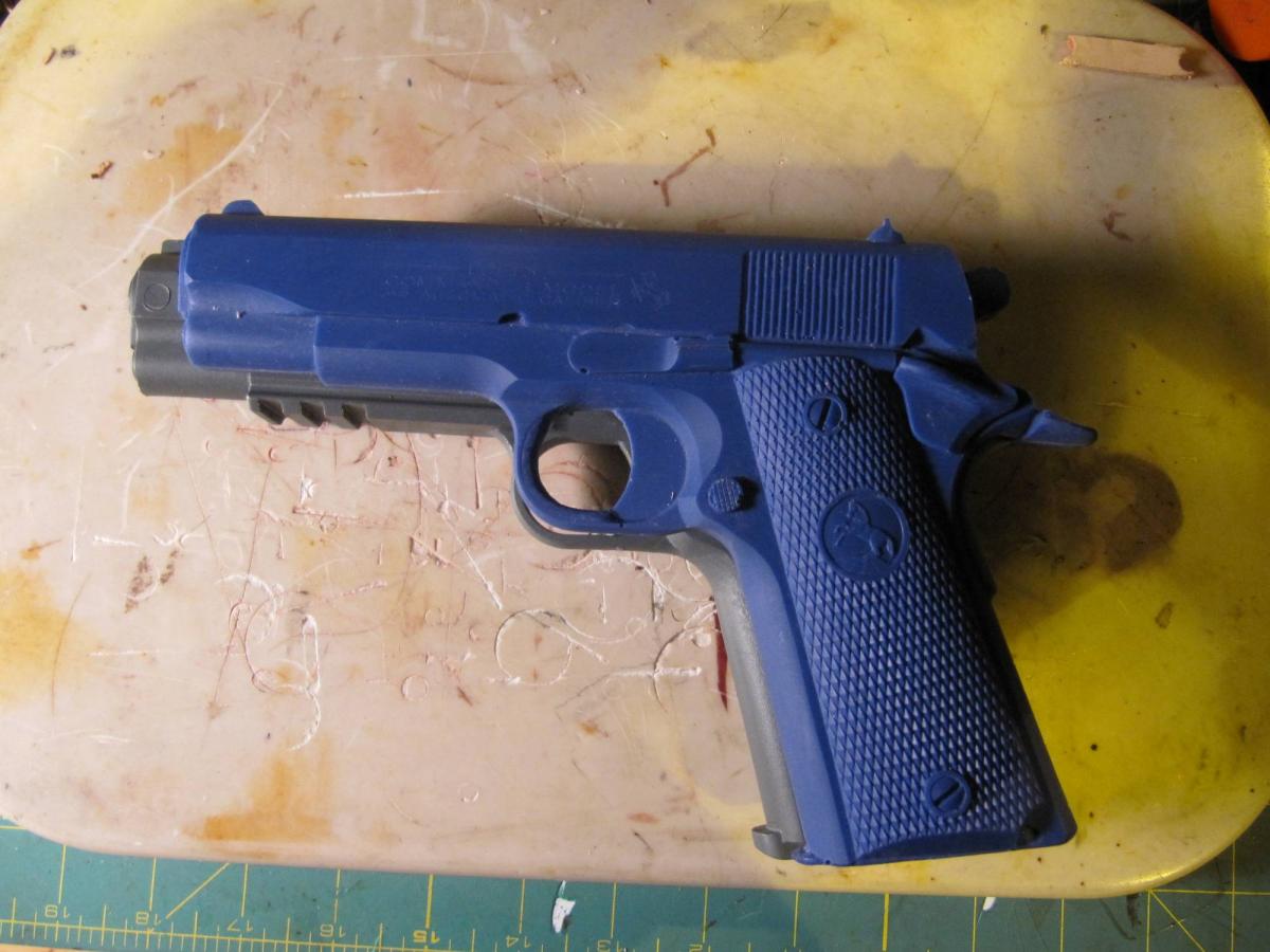

GLockanator here are some pictures for comparison. One will not work for the other as is. However if you are going to modify it it might be doable, however it will take a lot of cutting grinding and shaving plastic. -

GLockanator, I will take a picture of the blackhawk and the comander together you will be able to compare. Give me a couple of hours. -
