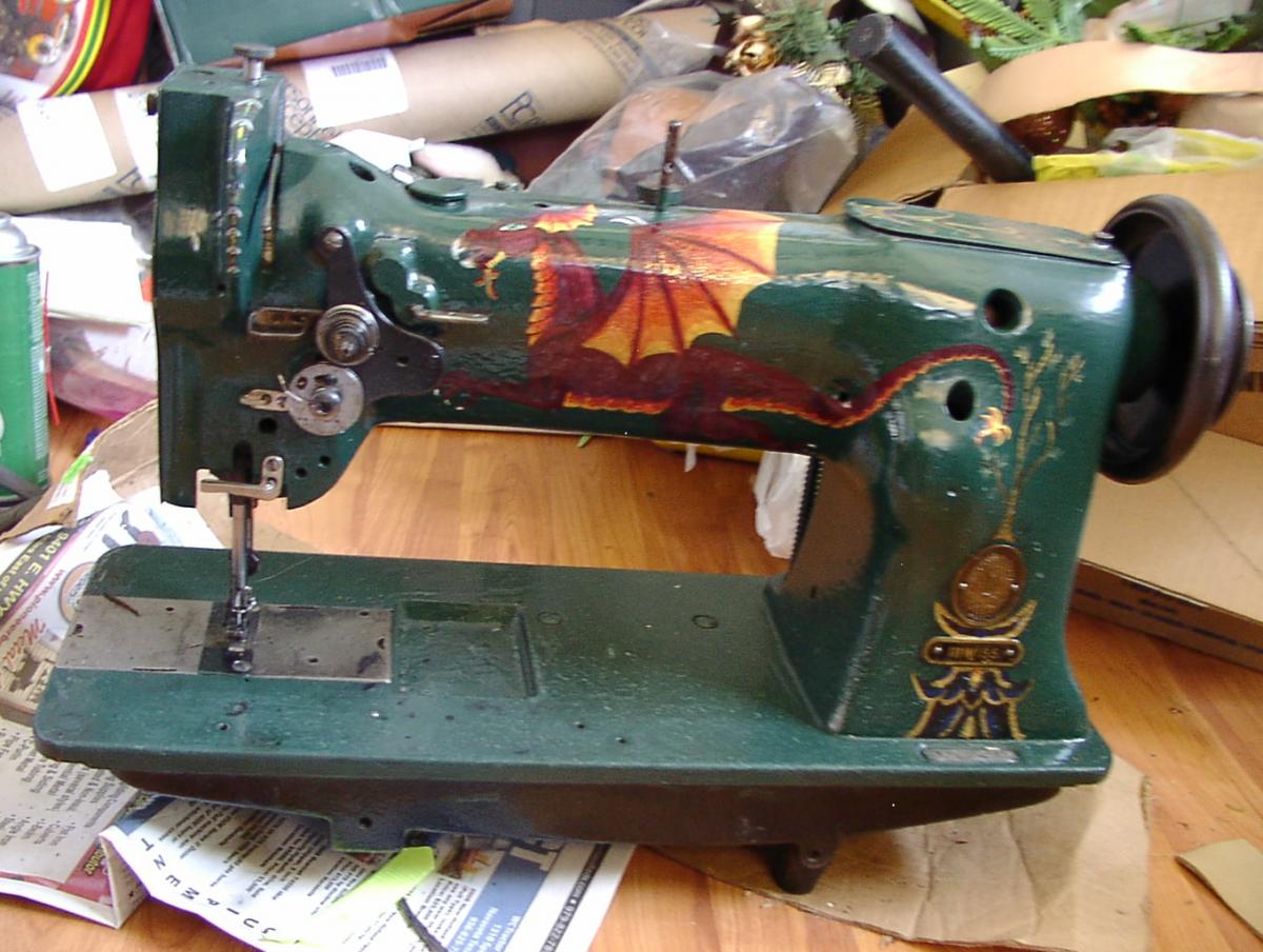

I have a recently aquired Singer patcher and it only has about 1/2 the paint left on it. Does it devalue to go with a non-stock paint job? Otherwise I'm thinking fantasy or nose art. Samples: and since I can't load what might be my #1 choice (sitting lady in red & white 2 piece with the phrase "Do What?" here's the traditional paint job too. I'm looking for similar suggestion - no porn here please
