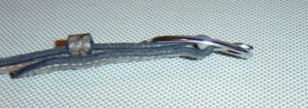

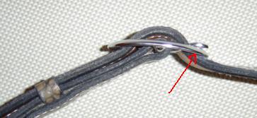

You can dull the top of that blade and put a heat shrink over it.

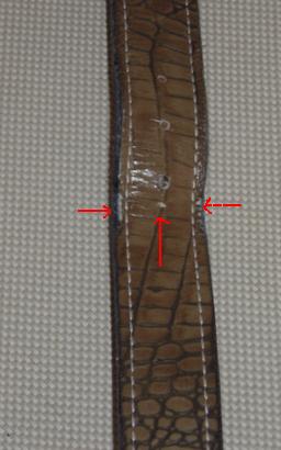

This is the leather I http://springfieldle...b,Antique-Pink/ The buckle has a slight curve to it but it shouldn't be rubbing through the embossed surface within a week. It only appears to be rubbing through on one side but it's the total width of the buckle. I've already made several so I'm not too happy about it considering it is advertised for use in making belts.
3-4 oz. isn't very heavy for stamping. Granite might have been a better choice than the steel for stamping but you can use nylon or poundo board on top of your steel plate.
