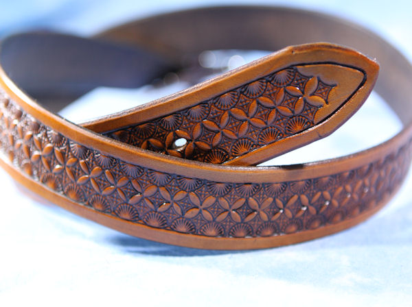

Lets start with my error. I left out one step on the list. I did the belt below by stamping it, It's Herman Oak leather. Then died it with the new tan stain from Tandy. 1 Coat of Neetsfoot oil, let set over night. Then 2 coats of 50/50 resolene let dry over night. Used the Tandy Eco-fo Antique dk brown. Applied it on the thick side and took a damp flat cloth and wiped it off. Changed the cloth often and only used it flat never bunched. This way it wiped the antique off the high points of the design and the plain border. 1 coat 50/50 resolene stitched it. 1 coat 50/50 resolene then rubbed in Kiwi neutral polish with my fingers and buffed it with sheep wool. The neetsfoot oil is to recondition the leather. Do it before you resist. Resolene is an acrylic finish. It works really well as a resist. I dilute it 50/50 with water then apply it with a 1" foam brush. Let dry an hour and do the second coat than let dry over night. Then do the antique. FYI, on the antique, I ammpy it a little on the thick side. I dont rub it in just aly it on thick so it getts down in to all the stamped and cut areas. Then when I remove it there is a lot in the deep places. Your problems with the belt are a result of a few issues. 1: your leather looks like it was too wet when you stamped it. You have no real definition in the stamp marks. This causes the antique to get wiped out. You need deeper stamps. Leather that is too wet will not keep the stamp marks well. Re-wetting the leather will cause it to swell and make the stamp marks shallow. When you case the leather wet it and then let it dry until it is almost the color of when it is dry. the surface might be a little dry but the core of the leather has the right moisture content. 2: You are using some of the worse stamps Tandy makes. Both of the large flowers are nasty. I have both of them and its very hard to get a good clear impression. You will notice that the only place you for some of the resist to stick was the one small flower that had some deep impressions. The leaf stamp is also pretty light. Along with the cacsed leather make sure you give it a good smack with the mallet. Try some other stamps. Something you have that makes a good impression. It does not need to look like a great design you are making a test piece. Stamp a few designs on some well cased leather. If you want make 2-3 impressions off all the stamps you have. Then follow the steps I listed in this email. If you do not have any neetsfoot oil use olive oil. It works well. Make sure you let the oil sit over night. Using resolene as a resist let that dry over night after the second coat. Then antique and let that dry. Then apply one coat of the resolene. I have also used leather balm & atom wax as the coat after the antique. Buff after its dry. The kiwi polish is to give the leather a final, additional finish. It takes the gloss from the resolene down a notch or two. Once you case it correctly and get a good stamp to use you will see that the rest will all come together just fine. Let me know if you have and additional questions. I am happy to help. If you really want the impressions to be light you are going to have to wipe the antique off very gently. Make sure to leave it in the impressions. I might try wrapping a cloth around a sanding block or something else flat to make sure the cloth doenst get in to the impressions. It just takes practice. Keep working on practice pieces until you get it right. Learn it first on good deep impressions then work on getting it on light impressions.
A picture of the belt you had problems with would help. I did the belt below by stamping it, It's Herman Oak leather. Then died it with the new tan stain from Tandy. Then 2 coats of 50/50 resolene let dry over night. Used the Tandy Eco-fo Antique dk brown. Rubbed it on and took a damp flat cloth and wiped it off. Changed the cloth often and only used it flat never bunched. This way it wiped the antique off the high points of the design and the plain border. 1 coat 50/50 resolene stitched it. 1 coat 50/50 resolene then rubbed in Kiwi neutral polish with my fingers and buffed it with sheep wool. FYI you can remove the antique if it smears on the unstamped places with an alcohol wipe. takes it right off but you need to put more resolene on the area. It worked well for what I wanted. Like I said we really need to see your belt to tell what happened. You can see more about this belt here
